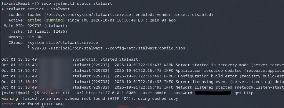

systemctl says its in recovery mode but I still get that same 404.
In recovery mode Stalwart only listens on plain HTTP on port 8080, nothing on 443, and the endpoint access rule is switched off. So if the 404 comes from https:// on your domain, it’s being answered by some other process: another Stalwart instance or container, an old service, or a proxy. A 404 for /admin on port 8080 would be something else again (the WebUI bundle), so I need to know which of the two you’re hitting. The screenshot is too small to read; can you paste the exact URL or command that gave the 404, plus the output of these, run on the server while it’s in recovery mode:

Not 100% sure what resolved things, but at some point in the past, I’d set the point to 9090, to fix the issue I was having with crowdsec eating 8080, but everything got set back to 8080 after I upgraded to 0.16 a while back.
Good news, something in the last few commands DID fix things. Thanks for the help! (bad news, not a clue what it specifically was)
Glad it’s back. CrowdSec’s API also listens on 8080 by default, the same port recovery mode uses, so it may well have been what answered some of those 404s. If you need recovery mode again, add STALWART_RECOVERY_MODE_PORT=9090 next to the other two lines. And make sure STALWART_RECOVERY_MODE and STALWART_RECOVERY_ADMIN are gone from /etc/stalwart/stalwart.env now; otherwise the next restart puts you back in recovery mode with that admin password still sitting in the file. Details: Environment variables | Stalwart
