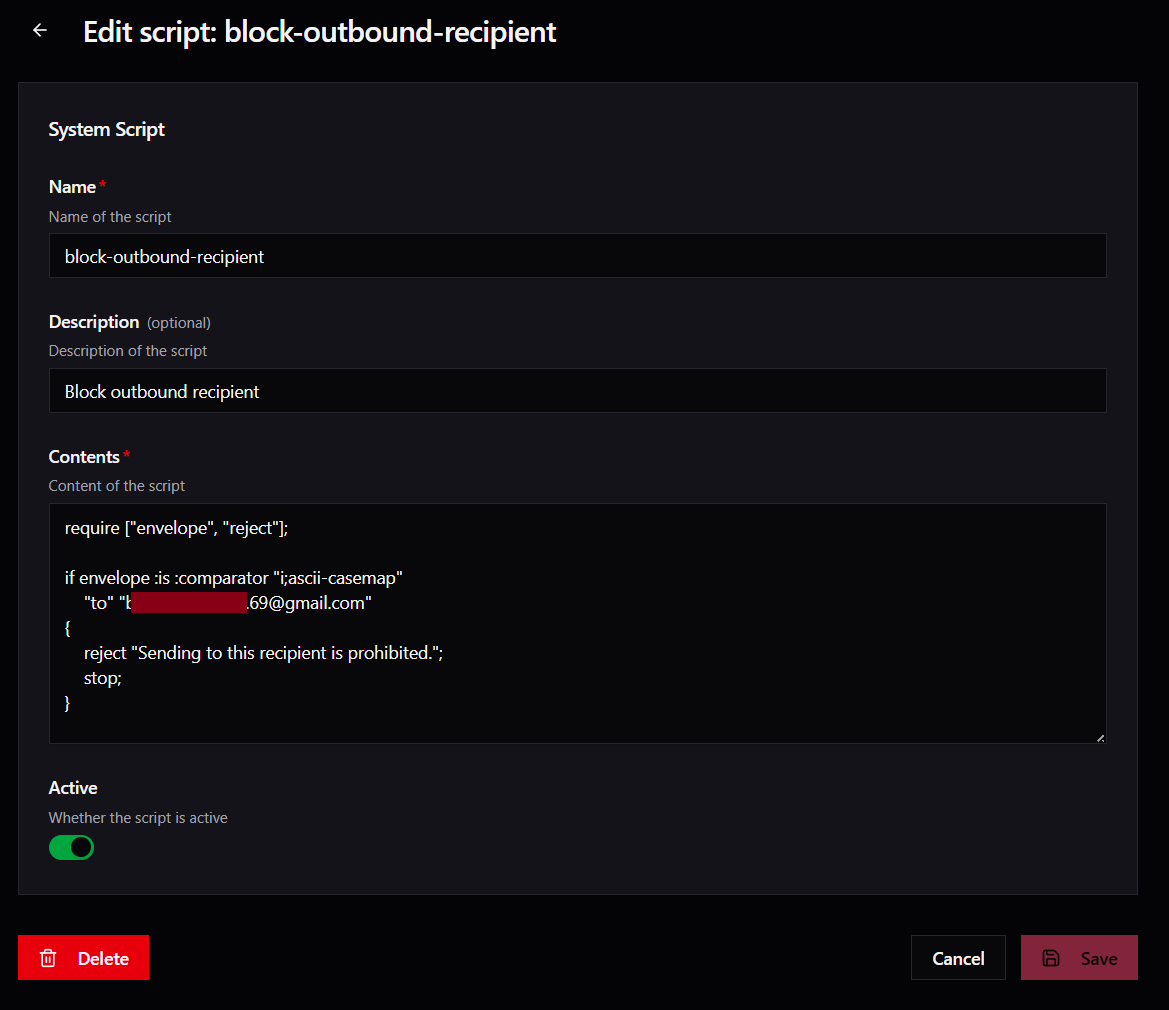

You can implement this with System Sieve scripts.
Create each script under:
Settings → Sieve → System Scripts
Then attach it to the correct SMTP stage under:
Settings → MTA → Session
The stage matters because an SMTP transaction happens in this order:
MAIL FROM → RCPT TO → DATA
Official overview:
Block outbound email to a specific recipient
Example: prevent authenticated users from sending to:
[email protected]

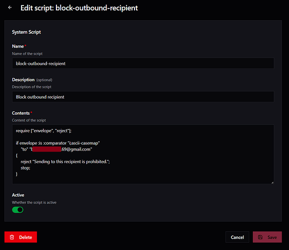

Create a System Script named block-outbound-recipient:
require ["envelope", "reject"];
if envelope :is :comparator "i;ascii-casemap"
    "to" "[email protected]"
    reject "550 5.7.1 Sending to this recipient is prohibited.";
    stop;
Attach it to:
Settings → MTA → Session → RCPT TO Stage → Run Script
Configure:
IF      !is_empty(authenticated_as)
THEN    'block-outbound-recipient'
ELSE    false
Why use the RCPT TO stage?
The recipient does not exist yet during MAIL FROM. It becomes available when the client sends:
RCPT TO:<[email protected]>
Rejecting at this stage stops the message before Stalwart receives its body or adds it to the outbound queue.
The authenticated_as condition limits the rule to authenticated outbound users and applications. Without that condition, the rule could also affect inbound email.

I can’t even remember why I set this up for the email address I’ve hidden, but it worked. I have the documentation on how to block an entire domain, but I’m checking to make sure everything is correct—I have some doubts.
