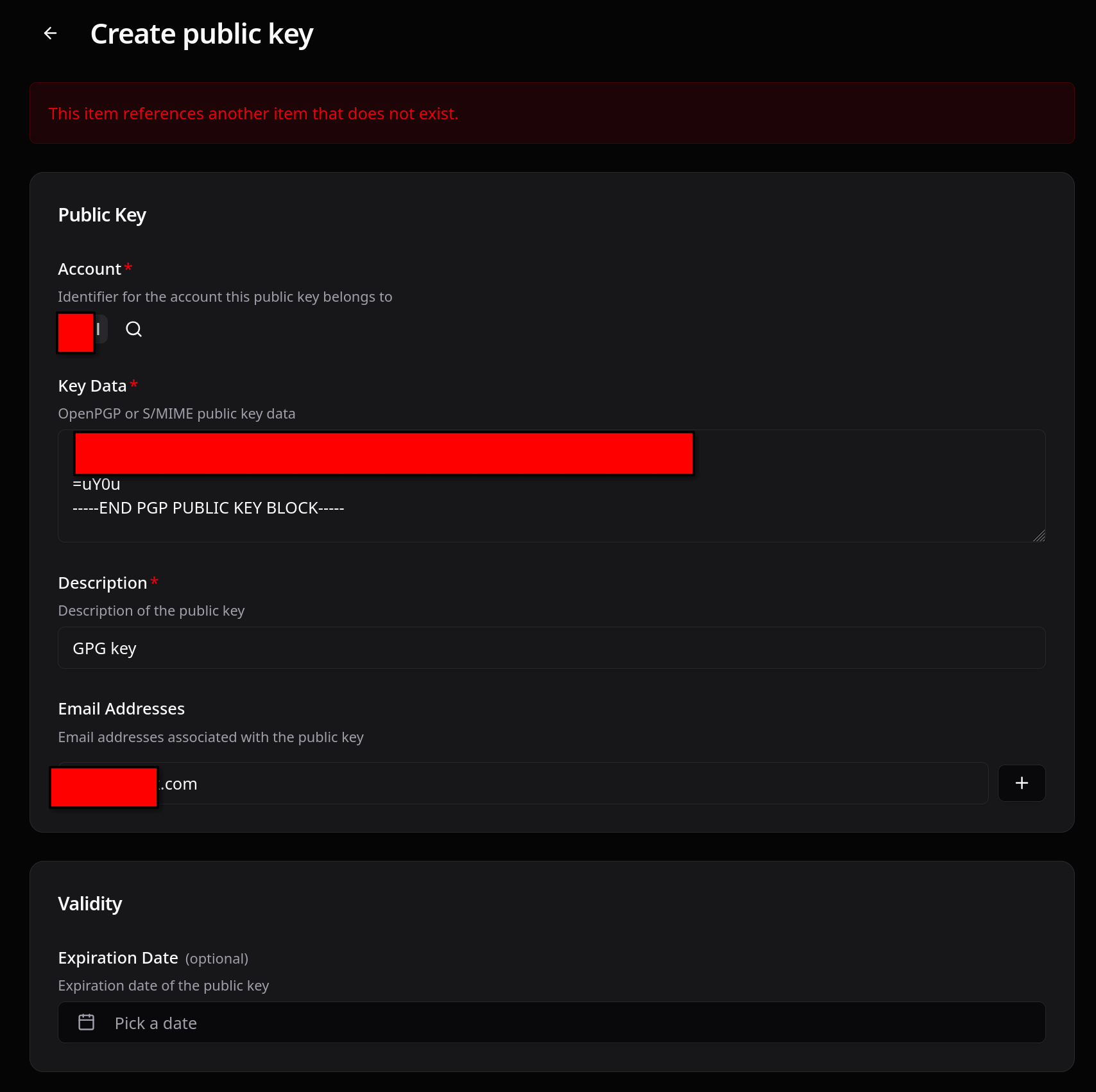

I am getting the same error. See screenshot below. I searched/selected the Account and provided the PGP key. I was trying to do this with the ‘admin’ user.
If i try to do with a role ‘User Role’ of another account, i dont even get the setting to set gpg key.
Try to properly export the public key. I had the same issue due to a corrupted public key export.
If i create a user with ‘Administrator Role’ i am able to create a Public Key. However if a user has ‘User Role’ i get that error message.
I am wondering if this is a permission issue. Is there any specific permission which a ‘User Role’ needs to have to create Public Key?
@trumee that error means the accountId on the create did not resolve, so it is about the account reference rather than the key material or anything wrong with the key itself.
The role explanation does not quite hold up, which is why I want more detail before guessing. On a stock install the User role already carries the public-key permissions (they are in the default user and group permission sets, not just the superuser one), and a missing permission would come back as a forbidden error rather than an invalid foreign key. So either the roles in your install have been customised, or the two cases differ in which account is actually being referenced.
Could you post the create request payload and the JSON error response from the browser network tab, and say whether you are signed in as an admin creating the key for a User-role account or signed in as that user? Also useful: the effective permission list on the failing account (specifically whether sysPublicKeyGet and sysPublicKeyCreate are there), your version, and whether this install was migrated from an earlier 0.16.x. Separately, is the “no key field at all” you mentioned the same accounts, or a different symptom?
After setting the Roles in account/Management/x:Role the problem went away.
