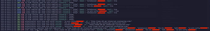

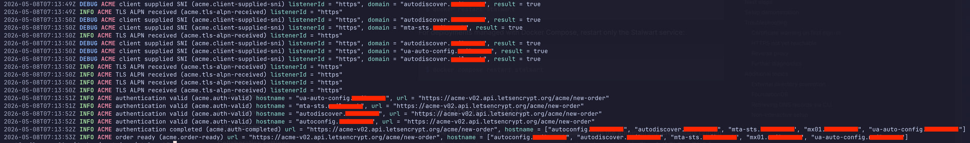

  • Logs look fine (see image)
However, when accessing Stalwart via browser, only the self signed certificate is presented, not the Letsencrypt certificate.
