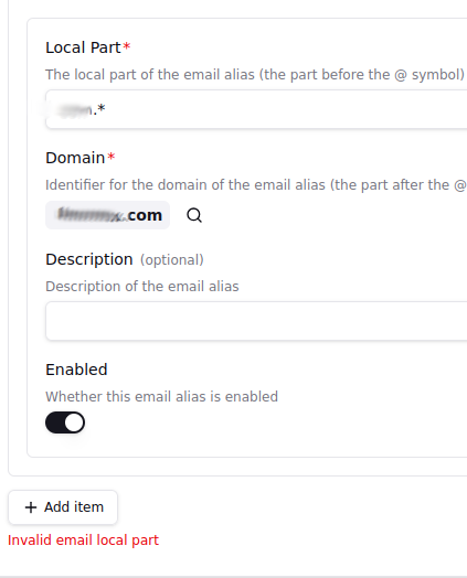

Based on a tip from Matrix channel, I also tried to set up an alias for the account, with local part `prefix.*`, but that wasn’t accepted either, it gives error “Invalid email local part”:
A few things are tripping you up at once and they’re easy to mix up.
The alias attempt with the local part prefix.* was never going to work. Stalwart only accepts alphanumerics and ., +, -, _ in local parts (same restriction as RFC 5321 plus a sanity check), so * is rejected at validation time. There’s no wildcard alias mechanism, that’s not what aliases are for.

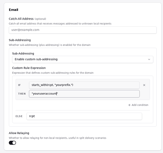

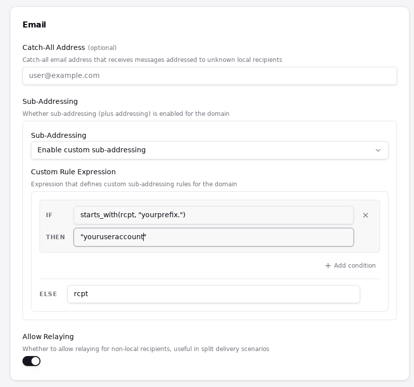

I can now confirm that the problem is with this regexp. I used exactly that regexp as you suggested (just replaced “prefix” with my prefix), and it does not work. There is no compile error at startup. But the message is rejected with “mailbox does not exist”.
If I use
starts_with(rcpt, "prefix.")
as condition, then it does work. Thanks for the tip for that function.
So, I can confirm that the problem is not with the subaddressing feature, but with the `matches()` function or the regexp. Given that you say it should work, and the docs say it should work, it appears to be a bug.
There’s another problem: If I use `bar` as THEN, the WebUI happily accepts it, but it fails to compile. It expects `“bar”` with quotes - that’s not obvious at all. Stalwart complains on startup in the log, but that’s burried underneath tons of other messages. Configuration errors should be caught in the UI when I configure, not on next startup in the log.

/^prefix\..*@domain\.com$/    [email protected]
/^prefix2\..*@domain\.com$/   [email protected]
So at the end all emails like [email protected] goes to [email protected]. Even I can answer as this email too, I need to create new identity in a roundcube and reply with it.
So what will be equivalent of this postfix regexp config in stalwart? Basically this is only one feature that is still holding me back from stalwart.
That’s precisely my config as well. (Just that I use virtual.foo in Postfix.)
Here’s my config, in “Domains” section:
  • “Custom sub-addressing”
  • IF `starts_with(rcpt, “yourprefix.”)`
    THEN `“youruseraccount”` (with quotes)
    ELSE `rcpt`
However, I cannot remember right now whether I did that before or after the fix in this bug here, so I cannot 100% guarantee that this works. Sorry! I hope this helps anyways.
