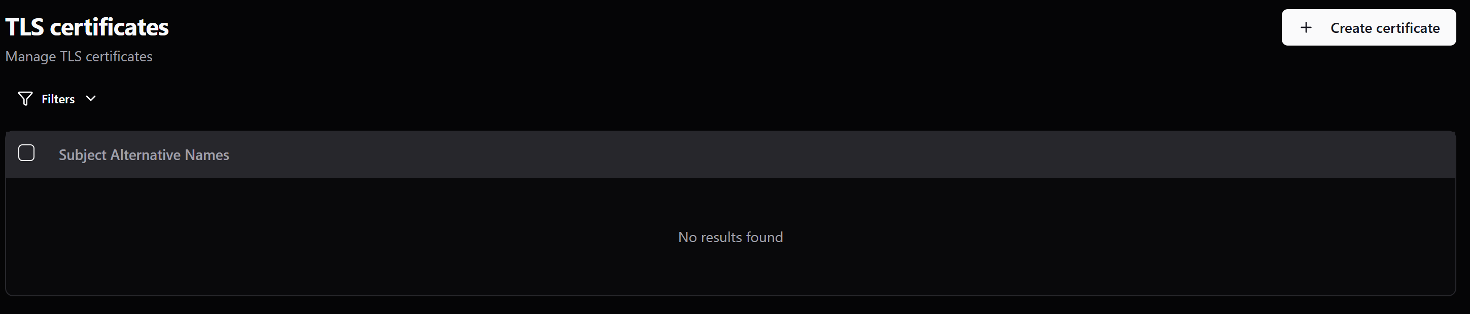

I run Stalwart Mail as a Docker container on my private home server. A reverse proxy (Caddy), included in the Docker Compose setup, handles the domain for my email as well as HTTPS access to the Stalwart WebGUI. Caddy also generates a TLS certificate for my domain.
I copied the certificate text into the Stalwart WebGUI (specifically here: https://meine-domain.de/admin/Settings/x:Certificate).
This worked without issues until yesterday. However, this morning, my email client (Microsoft Outlook) reported that the email address associated with the Stalwart server no longer had a valid certificate.
Upon checking the Stalwart WebGUI, I saw that the certificate list was empty; Stalwart had simply deleted the certificate I had manually entered.
I copied the certificate text from Caddy to Stalwart again and noticed Stalwart reporting that the certificate was only valid until yesterday (2026-06-23). However, when I check the certificate in Caddy, I see it is still valid for another 81 days. (My domain URLs also open via HTTPS without any error messages.)
I also noticed something else: whenever I stop and restart the Stalwart Docker Compose container, the certificate disappears from the WebGUI again. This happens every time the container restarts. Why is this happening?

I’ve managed to solve the problem. It turned out to be an issue with Caddy. For some reason, Caddy had switched from ACME to ZeroTLS for a new certificate, and the resulting certificate files were being stored in a different path. Consequently, I had been inadvertently reading and copying the expired certificate to Stalwart-Mail over and over again.
However, by adding a temporary entry to the Caddyfile, I was able to force Caddy to store a new ACME certificate in the usual location.
Caddyfile:
your-domain.de:443 {
  tls [email protected] {
    protocols tls1.3
    # === force new ACME certificate ===
    ca https://acme-v02.api.letsencrypt.org/directory
Once I copied this valid certificate to Stalwart-Mail, it was no longer automatically deleted when the container restarted. I do find this behavior in Stalwart-Mail problematic, though. I don’t recall encountering this kind of behavior with version v0.15.x. I would prefer it if Stalwart-Mail notified me that a certificate had expired instead of simply deleting it. Is there any way to improve this?
