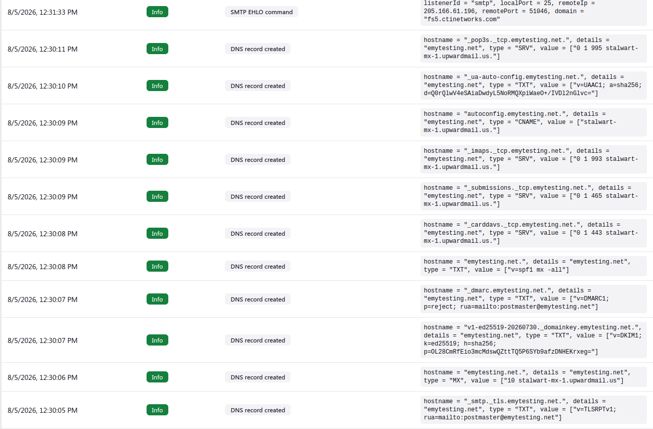

Upgraded to 0.16.16, I didnt see the fix in the change list. But I tried again.
Failed to set DNS RRSet for v1-rsa-20260730.domainkey.emytesting.net./TXT: Failed to set DNS RRSet: API error: NameSilo error 280: ttl: You must be between 3600 and 2592000; Failed to set DNS RRSet for mta-sts.emytesting.net./CNAME: Failed to set DNS RRSet: API error: NameSilo error 280: Field \u0022Target hostname\u0022 should be valid. Please use only letters (A-Z, case-insensitive), numbers (0-9), and hyphens (-).; Failed to set DNS RRSet for _pop3s._tcp.emytesting.net./SRV: Failed to set DNS RRSet: API error: NameSilo error 280: target:stalwart-mx-1.upwardmail.us. must be a valid host; Failed to set DNS RRSet for _carddavs._tcp.emytesting.net./SRV: Failed to set DNS RRSet: API error: NameSilo error 280: target:stalwart-mx-1.upwardmail.us. must be a valid host; Failed to set DNS RRSet for _dmarc.emytesting.net./TXT: Failed to set DNS RRSet: API error: NameSilo error 280: ttl: You must be between 3600 and 2592000; Failed to set DNS RRSet for emytesting.net./TXT: Failed to set DNS RRSet: API error: NameSilo error 280: ttl: You must be between 3600 and 2592000; Failed to set DNS RRSet for v1-ed25519-20260730.domainkey.emytesting.net./TXT: Failed to set DNS RRSet: API error: NameSilo error 280: ttl: You must be between 3600 and 2592000; Failed to set DNS RRSet for ua-auto-config.emytesting.net./CNAME: Failed to set DNS RRSet: API error: NameSilo error 280: Field \u0022Target hostname\u0022 should be valid. Please use only letters (A-Z, case-insensitive), numbers (0-9), and hyphens (-).; Failed to set DNS RRSet for _caldavs._tcp.emytesting.net./SRV: Failed to set DNS RRSet: API error: NameSilo error 280: target:stalwart-mx-1.upwardmail.us. must be a valid host; Failed to set DNS RRSet for _mta-sts.emytesting.net./TXT: Failed to set DNS RRSet: API error: NameSilo error 280: ttl: You must be between 3600 and 2592000; Failed to set DNS RRSet for _submissions._tcp.emytesting.net./SRV: Failed to set DNS RRSet: API error: NameSilo error 280: target:stalwart-mx-1.upwardmail.us. must be a valid host; Failed to set DNS RRSet for _ua-auto-config.emytesting.net./TXT: Failed to set DNS RRSet: API error: NameSilo error 280: ttl: You must be between 3600 and 2592000; Failed to set DNS RRSet for _smtp.tls.emytesting.net./TXT: Failed to set DNS RRSet: API error: NameSilo error 280: ttl: You must be between 3600 and 2592000; Failed to set DNS RRSet for autodiscover.emytesting.net./CNAME: Failed to set DNS RRSet: API error: NameSilo error 280: Field \u0022Target hostname\u0022 should be valid. Please use only letters (A-Z, case-insensitive), numbers (0-9), and hyphens (-).; Failed to set DNS RRSet for emytesting.net./MX: Failed to set DNS RRSet: API error: NameSilo error 280: ttl: You must be between 3600 and 2592000; Failed to set DNS RRSet for _imaps.tcp.emytesting.net./SRV: Failed to set DNS RRSet: API error: NameSilo error 280: target:stalwart-mx-1.upwardmail.us. must be a valid host; Failed to set DNS RRSet for autoconfig.emytesting.net./CNAME: Failed to set DNS RRSet: API error: NameSilo error 280: Field \u0022Target hostname\u0022 should be valid. Please use only letters (A-Z, case-insensitive), numbers (0-9), and hyphens (-).; Failed to set DNS RRSet for _jmap._tcp.emytesting.net./SRV: Failed to set DNS RRSet: API error: NameSilo error 280: target:stalwart-mx-1.upwardmail.us. must be a valid host
Looks like JSON/XML issue is solved. But we’re onto new issues now.
  1. Looks to be an issue setting the TTL. Guessing that its set too low by default in Stalwart. Needs to be at least 3600 in NameSilo.
  2. Something is out of line with the host name. I think the trailing dot at the end of the full hostname needs to be removed from the api submission.
AI Says:
the crate does already do this stripping elsewhere — list_at() (line 218) uses fqdn.trim_end_matches('.') when comparing hostnames — so the pattern for handling this exists in the file, it’s just not applied to the values sent to add_record for CNAME/MX/SRV.
I’d be willing to take a crack at a fix for this and compile the binary myself. If fixed, then deliver a pull request if that would be allowed???
Ken
We have just fixed those errors on the dns-update crate. If you have the possibility, please test the main branch of dns-update against your NameSilo account. If the fix works we’ll include it in v0.16.17.
Funny, I fixed them too and compiled my code and it worked. I will test the “official fixes” as well. More soon.
I no longer “fear cargo build”.

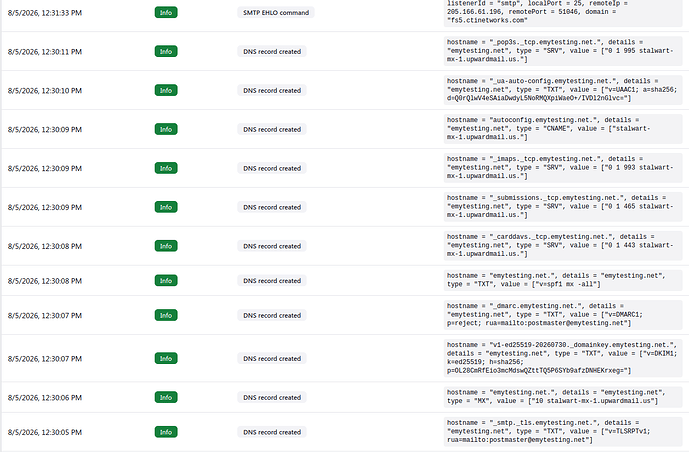

I can confirm that the latest dns-update v0.5.6 and it’s changes fix integration with NameSilo. This was tested with a valid API key and a valid domain.
Thanks, we’ll include the fix in v0.16.17.
