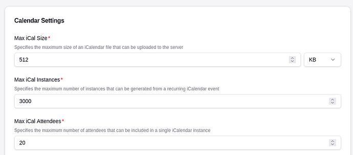

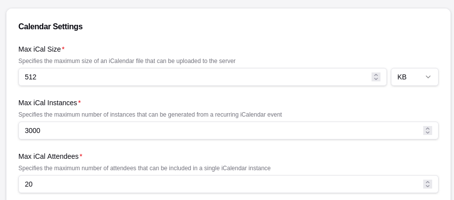

Thank you for the reply @stalwart . My settings are default, as seen below. The gap in question is only 9 years and it is a yearly event.
