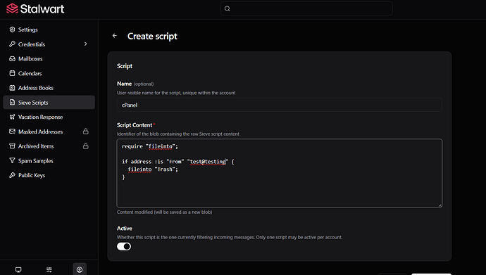

I’m using Stalwart WebUI.
Is referer /admin/Account because the user is Administrator.
This is the screenshot of the webpage where I’m trying to create the Sieve script:

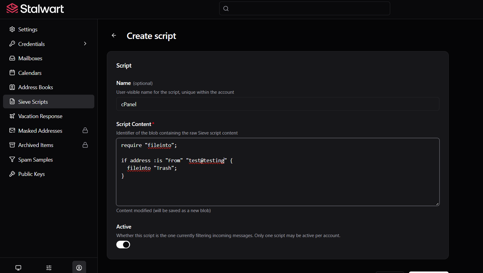

The same error I encounter if I’m trying from an user without Administrative role:
2026-07-03T09:53:14Z TRACE HTTP request body (http.request-body) listenerId = “https”, localPort = 443, remoteIp = 10.2.1.19, remotePort = 62233, details = [[“host”, “mail.example.ro”], [“connection”, “keep-alive”], [“content-length”, “428”], [“sec-ch-ua-platform”, ““Windows””], [“authorization”, “Bearer sw1.YM2IN-GIoq42gT4Jzl_ReWb8wVLbYj0XPzqEktfYBpX2G4ixwrHzj1j71UI9HVkSNqY.c2lsdml1LnV0YUByZWNlcHRpdi5ybw”], [“user-agent”, “Mozilla/5.0 (Windows NT 10.0; Win64; x64) AppleWebKit/537.36 (KHTML, like Gecko) Chrome/149.0.0.0 Safari/537.36”], [“sec-ch-ua”, ““Brave”;v=“149”, “Chromium”;v=“149”, “Not)A;Brand”;v=“24"”], [“content-type”, “application/json”], [“sec-ch-ua-mobile”, “?0”], [“accept”, “/”], [“sec-gpc”, “1”], [“accept-language”, “en-US,en;q=0.6”], [“origin”, “https://mail.example.ro”], [“sec-fetch-site”, “same-origin”], [“sec-fetch-mode”, “cors”], [“sec-fetch-dest”, “empty”], [“referer”, “https://mail.example.ro/account/Account/SieveScript/new”], [“accept-encoding”, “gzip, deflate, br, zstd”]], contents = “{“using”:[“urn:ietf:params:jmap:core”,“urn:stalwart:jmap”],“methodCalls”:[[“Blob/upload”,{“accountId”:“d”,“create”:{“temp-blob-0”:{“data”:[{“data:asText”:“reuire \“fileinto\”;\n\nif address :is \“From\” \“[email protected]\” {\n fileinto \“Trash\”;\n}”}],“type”:“application/octet-stream”}}},“blob-0”],[“SieveScript/set”,{“accountId”:“d”,“create”:{“new-0”:{“blobId”:”#temp-blob-0”,“isActive”:true,“name”:“Forward”}}},“set-0”]]}", size = 428
2026-07-03T09:53:14Z DEBUG Invalid JMAP result reference (jmap.invalid-result-reference) listenerId = “https”, localPort = 443, remoteIp = 10.2.1.19, remotePort = 62233, details = "Invalid reference to non-existing object “temp-blob-0” from “new-0"”
2026-07-03T09:53:14Z TRACE HTTP response body (http.response-body) listenerId = “https”, localPort = 443, remoteIp = 10.2.1.19, remotePort = 62233, contents = “{“methodResponses”:[[“error”,{“type”:“unknownMethod”,“description”:“Method Blob/upload requires capability urn:ietf:params:jmap:blob which is not present in the \“using\” property.”},“blob-0”],[“error”,{“type”:“invalidResultReference”,“description”:“Invalid reference to non-existing object \“temp-blob-0\” from \“new-0\””},“set-0”]],“sessionState”:“5ebc9e46”}”, code = 200, size = 360
As you can see the refferer nou is /account/Account instead of /admin/Account.
