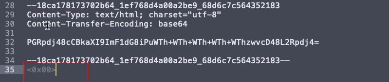

SO hit the same “problem”, after digging into the 0.16 code and checking diff with 0.15 it seems that the put blob method has changed, and essentially writes an extra 0 byte in 0.16 vs 0.15. In theory this means that if any of the blobs have a 0 byte (NO CLUE IF THIS IS POSSIBLE), it will be eaten.

@stalwart, I would argue this is either a bug, or a missing migration step. What should be done when you have many many many blobs pre 0.16 that are uncompressed and are missing this additional marker null byte?
Edit: in theory I think we could do a Database Migration | Stalwart export/import to “fix” this, but it feels rather heavy…
You’re right; indeed, the blob in version 0.16 has extra 0x00 bytes. My blob is stored in S3.
The warning itself is harmless, that branch returns the data exactly as stored. In 0.16 we append a single marker byte to each blob to record how it was encoded, 0.15 didn’t write one for uncompressed blobs, and the reader notices it’s missing and carries on. Only stores with compression disabled are affected; LZ4 blobs have the same layout in both versions.
The warning is the good case. We decide what to do by looking at the last byte, so a legacy blob whose real final byte happens to be 0x00 gets treated as marked and comes back one byte short, and one that happens to end in 0xa1 gets sent to the LZ4 decoder and fails the read. Neither of those logs anything. It works out to roughly one in 256 blobs for each case, and it’s mostly harmless for stored messages, which end in text, but not for arbitrary uploads or file storage.
