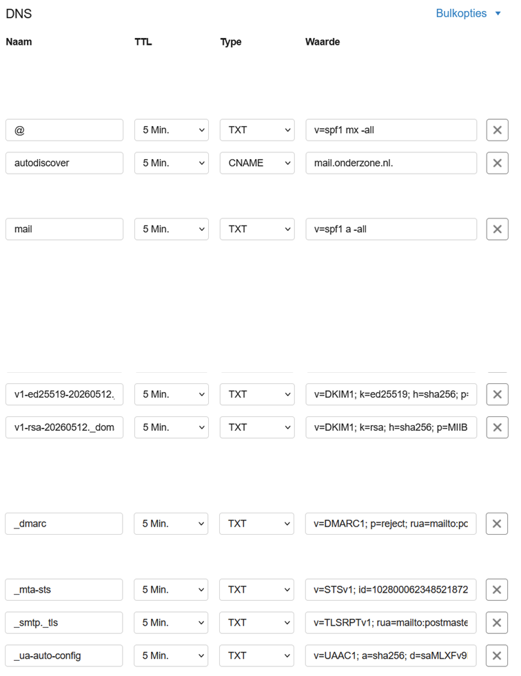

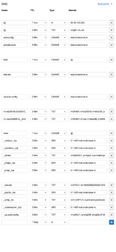

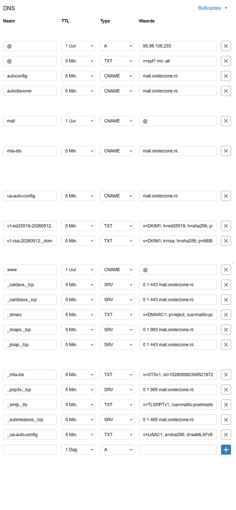

Please note in the screenshot that the mail-CNAME was manually added by me earlier.
Failed to set DNS RRSet for mail.onderzone.nl.
/TXT: Failed to set DNS RRSet: API error: HTTP 406: {“error”:“A CNAME’s name must be unique, there cannot exist other records with the same name according to RFC 1035.: mail 3600 CNAME @”}; Failed to set DNS RRSet for onderzone.nl.
/MX: Failed to set DNS RRSet: API error: HTTP 406: {“error”:“A hostname for a CNAME, NS, MX or SRV record was not found (external hostnames need a trailing dot, eg. “example.com.”): @ 300 MX 10 mail.onderzone.nl”}

I removed all mail-related records entirely and re-ran the DNS update task.
It is not happy.

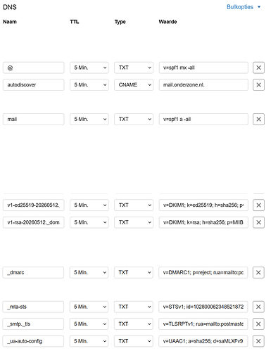

These succeeded:

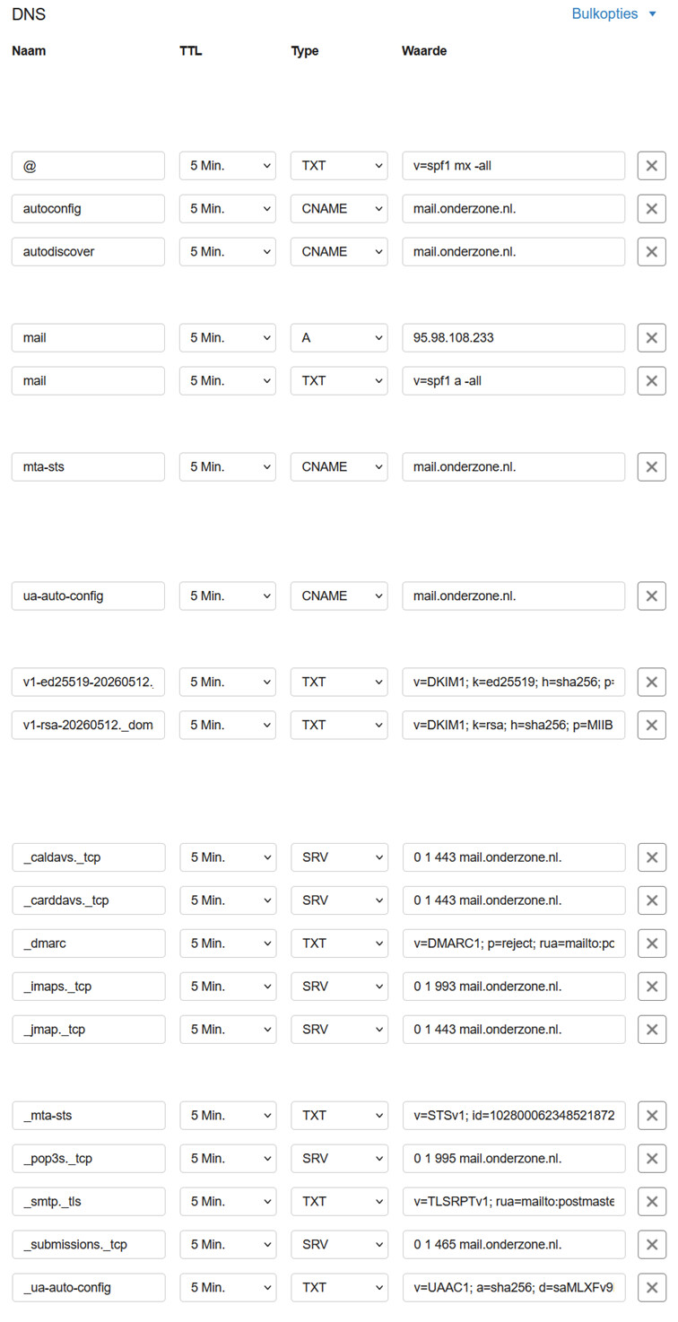

I tried it another way.
My mail.-subdomain used to be a CNAME-record. Manually added it as an A-record and re-ran the task.
This time there is only one error left about the absence of a trailing dot in the MX-record:
/MX: Failed to set DNS RRSet: API error: HTTP 406: {“error”:“A hostname for a CNAME, NS, MX or SRV record was not found (external hostnames need a trailing dot, eg. "example.com."): @ 300 MX 10 mail.onderzone.nl”}
All other records are OK. Will add the MX manually for now.
