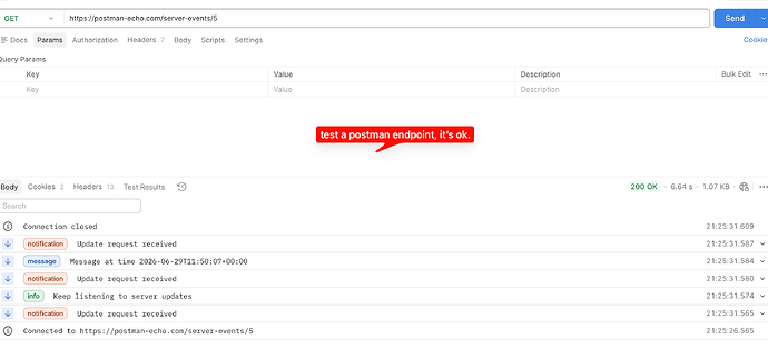

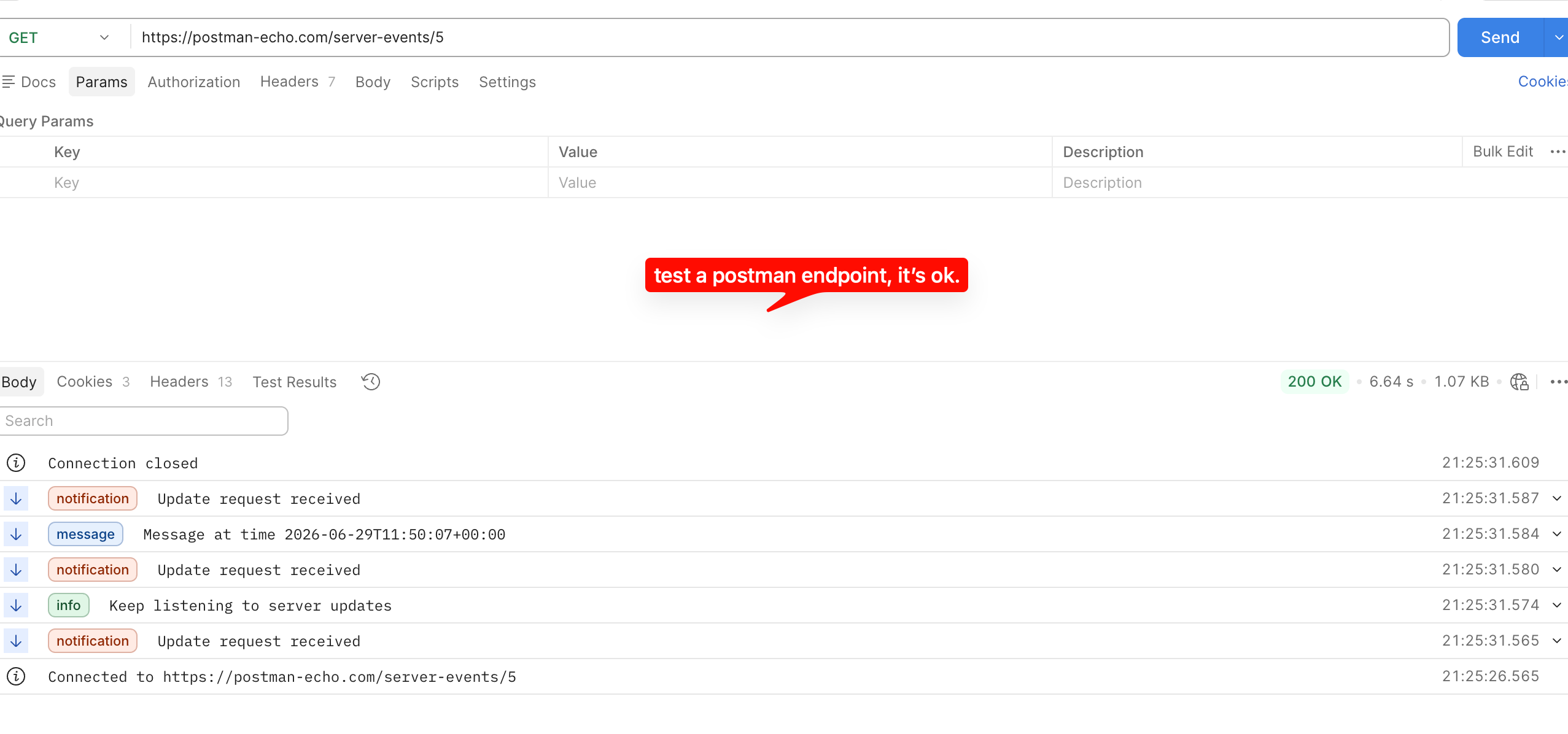

Baseline Test (Working Control)
To verify that my client-side setup and network support Server-Sent Events (SSE), I tested using Postman’s official echo endpoint:
Opened Postman on macOS and created a new HTTP GET request.
URL: https://postman-echo.com/server-events/5
Clicked Send.
Result: It works perfectly as expected, and events are streamed seamlessly (see attached file).

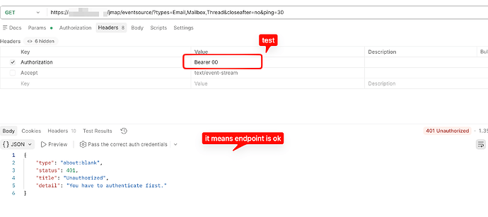

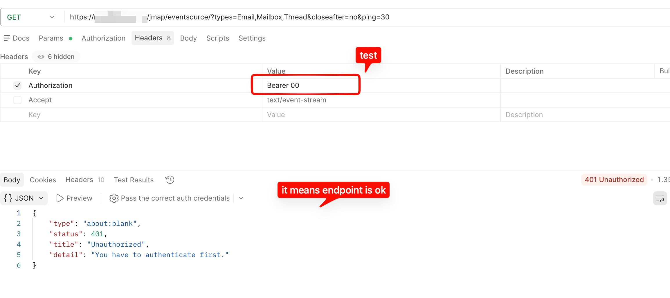

Test Case 1: Request WITHOUT Authorization header
Expected Behavior: The server should reject the request and return a 401 Unauthorized status code.
Actual Behavior: [Ok] Server returns 401 Unauthorized as expected.

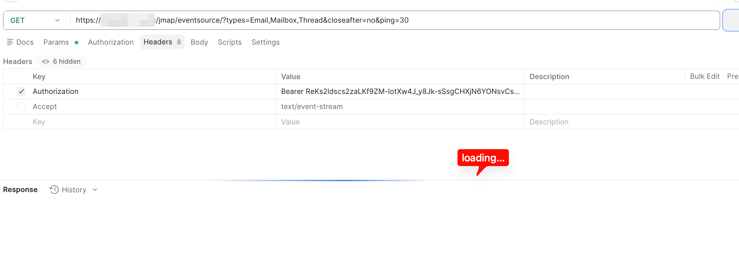

Test Case 2: Request WITH valid Authorization header
Expected Behavior: The server should establish a successful persistent connection and begin streaming JMAP events or ping data.
Actual Behavior: [Error] Postman shows a continuous, infinite “Loading…” state. No data or initial events are ever returned or rendered.

Endpoint URL is correct;
But do not work as expected:
The endpoint itself looks to be working: it returns 200 text/event-stream and auth succeeds (you get the correct 401 when unauthenticated). The catch is that it emits nothing until the first event or ping, and with ping=30 the interval is floored to 30 seconds, so a client can sit on “Loading” for up to ~30s before the first ping. Does it eventually stream a ping after about half a minute, or does it truly hang forever?
If it hangs indefinitely, the prime suspect is the reverse proxy buffering the SSE response (your headers show Caddy in front). SSE needs buffering disabled there (in Caddy, flush_interval -1 on the reverse_proxy).
The issue was indeed caused by the Nginx proxy on my end. For anyone else running into the same problem, you need to add these directives inside the location / block:
proxy_buffering off;
proxy_cache off;
chunked_transfer_encoding on;
