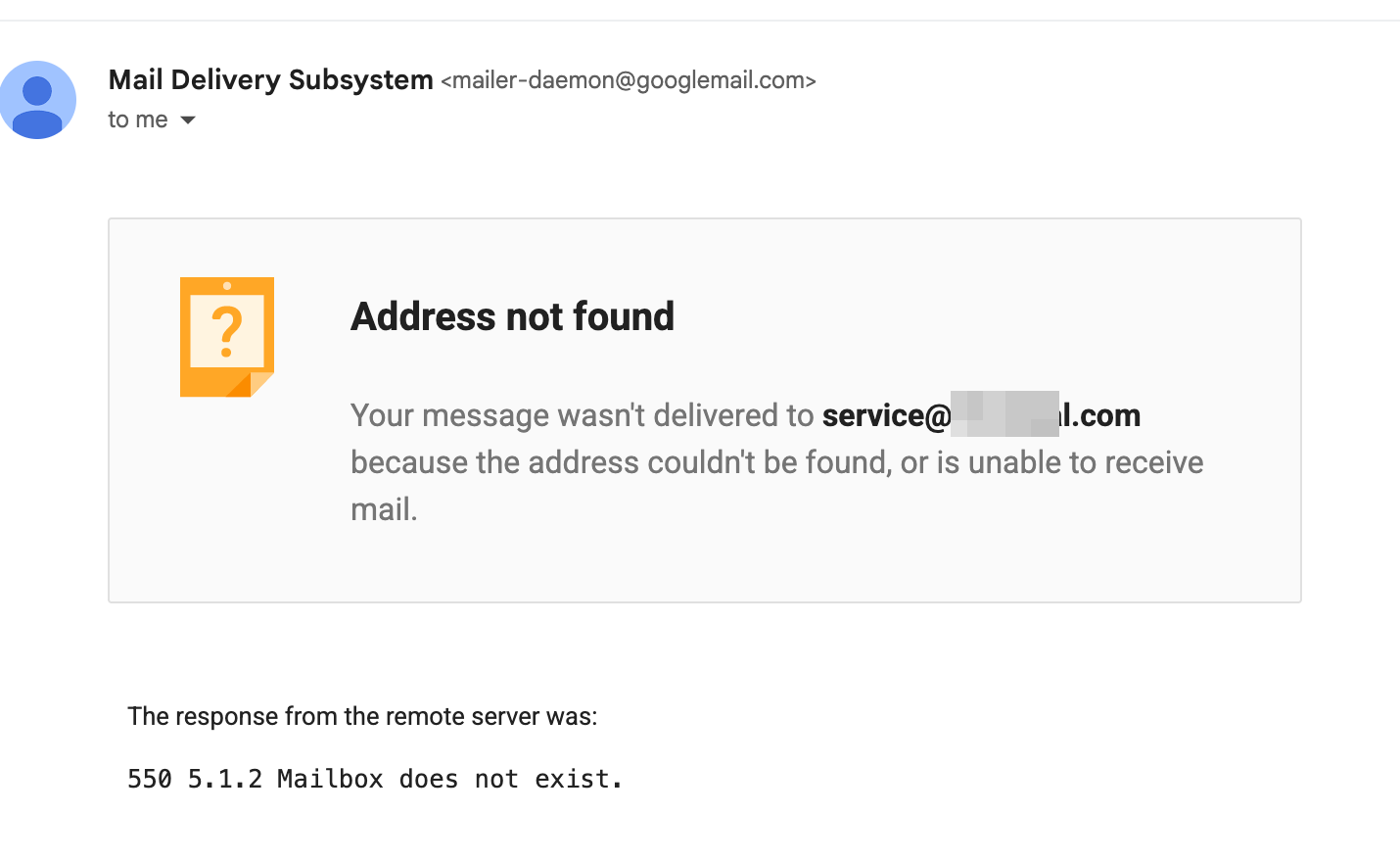

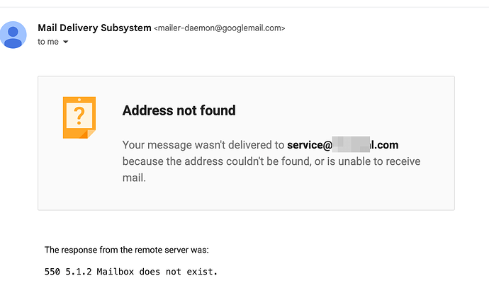

It’s not working on my end either. Here is my reproduction path:
  • Environment: Fresh installation of the latest Stalwart mail server (all default settings - RocksDB for all).
  • Setup: Completed initial setup and authentication.
  • Primary Email: Created a primary email account: admin@[example].com.
  • Client Testing: Configured the account on Apple Mail ==> OK. Sending and receiving emails works perfectly.
  • Alias Creation: Created an email alias for the primary account: service@[example].com.
  • The Issue: Attempted to send an email to the newly created alias address ==> Fail.

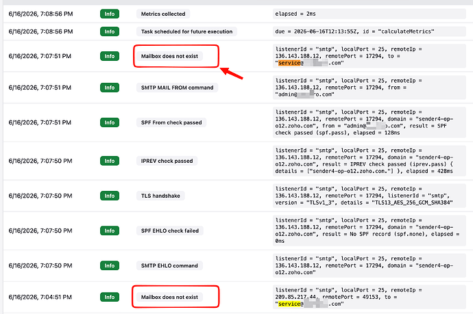

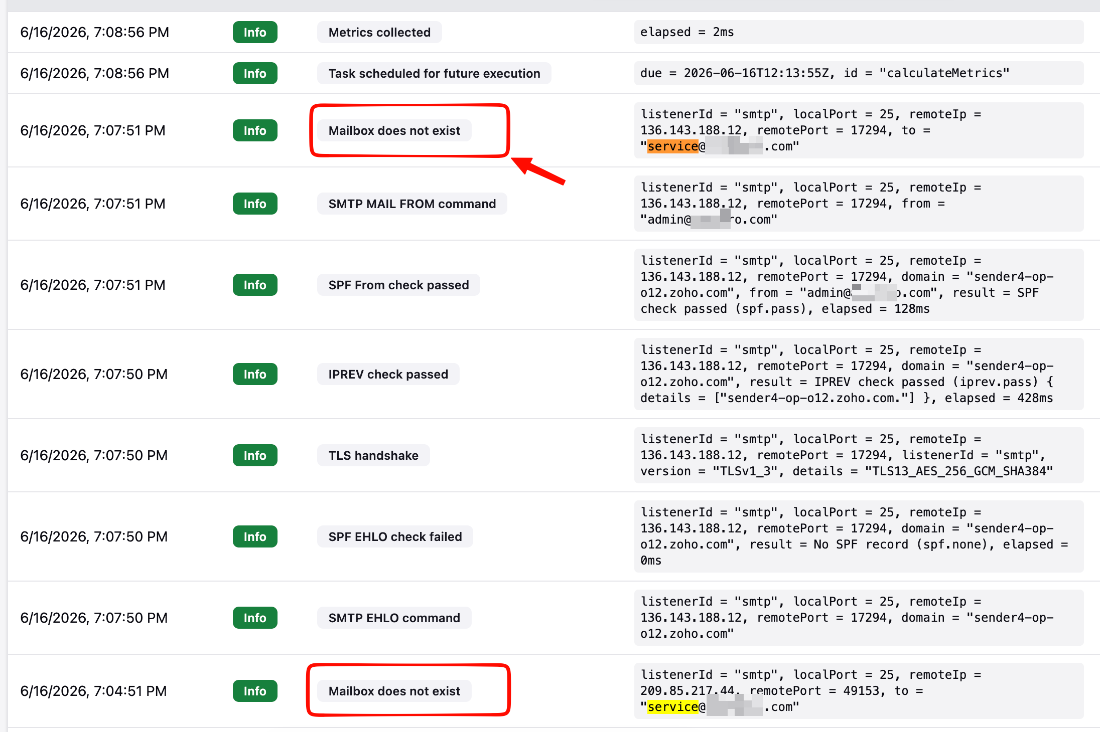

Logs & Extra Info:
  • The logs show the following error: Mailbox does not exist.
  • I have tested sending from both Gmail and Zoho Mail, but both failed with the same result.
Tried to reload Reload: Server settings then send email again => Still fail.
Just an update on my end: after I went to Actions and cleared both caches (Invalidate all caches and Invalidate negative caches), the email alias started working immediately and could receive emails perfectly.
