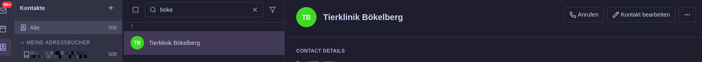

Checked the Web-UI, the characters are display correct there as they are also displayed correct in my email client (eM Client).
The number of contacts in the WebUI address book matches the number of contacts in the email client too.
