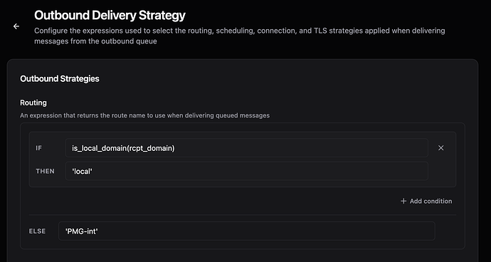

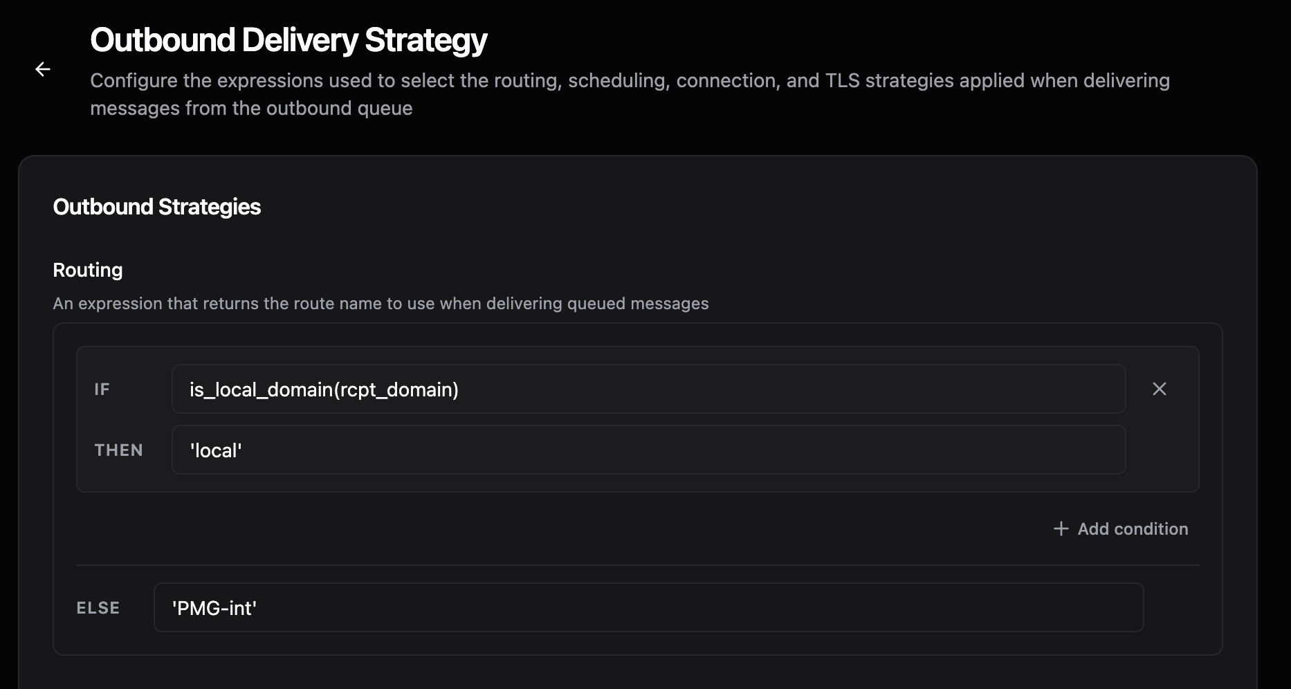

Configure MtaOutboundStrategy:
IF is_local_domain(rcpt_domain)
local
ELSE
aruba -
