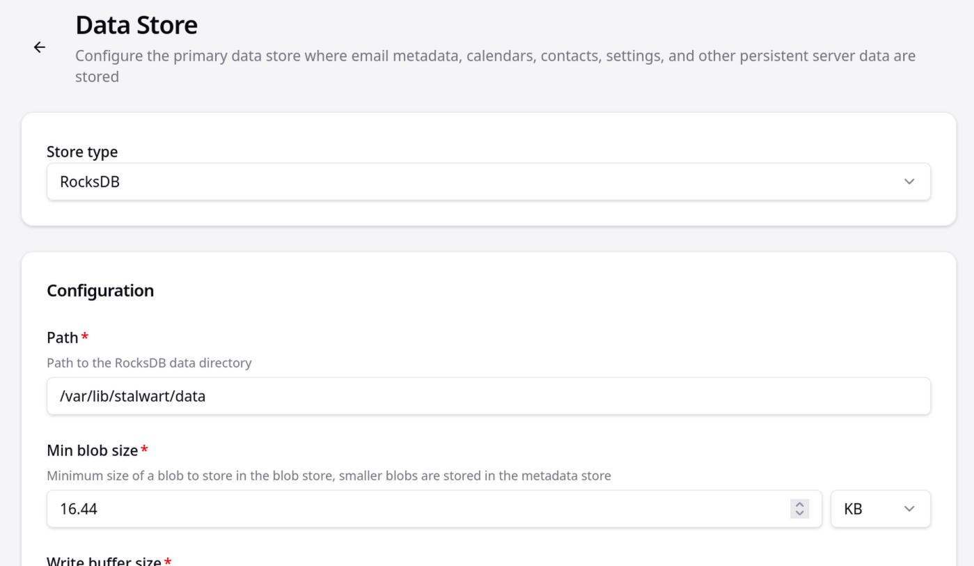

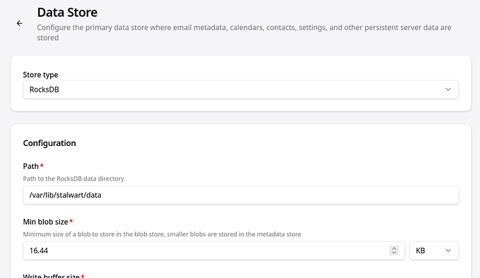

I can confirm that 0.16 is using /var/lib/stalwart/data as expect.
I have also tried copying the old DB to a mounted directory and following the migration steps. I can confirm that 0.16 does find the files, removes some of the files as expected but still fails to read the existing emails.
