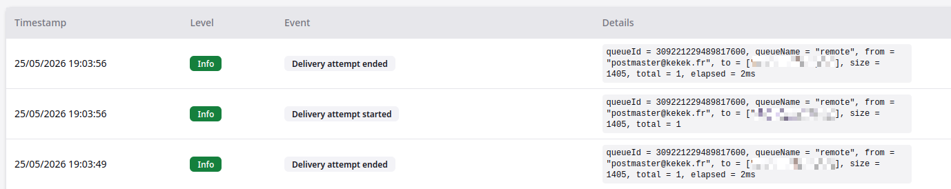

When there is mails in the queue, retry now or changing the queue mail attempts does not work because the retry datetime is not pasted. When I try to change it from the dashboard it does not work as well. It seems there is no option to force requeue of messages before the retry datetime.
Retry now would reset all queue messages to be sent now and changing the datetime of retry would work.
Retry now does not work nor changing the datetime retry.

Just delivery started and delivery ended without nothing done.

I tried now using a fake server with greylist so again a temporary failure. I have in logs “delivery started” but then it ends directly. However when the retry time arrives, the delivery starts normally.
I don’t think reschedule for permanent failure is interesting. A user interaction should be needed.
There seems to be a UI bug, but… There also seems to be a backend bug as well, appearing to do the retry, but it’s just an empty start/end cycle with no actual work.

Still seeing this in 0.16.8 when the message’s recipients are in a virtual queue (e.g. `remote`): “Retry Now” reports success, but nothing is persisted, and the scheduler only logs an empty 0 ms `attempt-start`/`attempt-end` pair.
