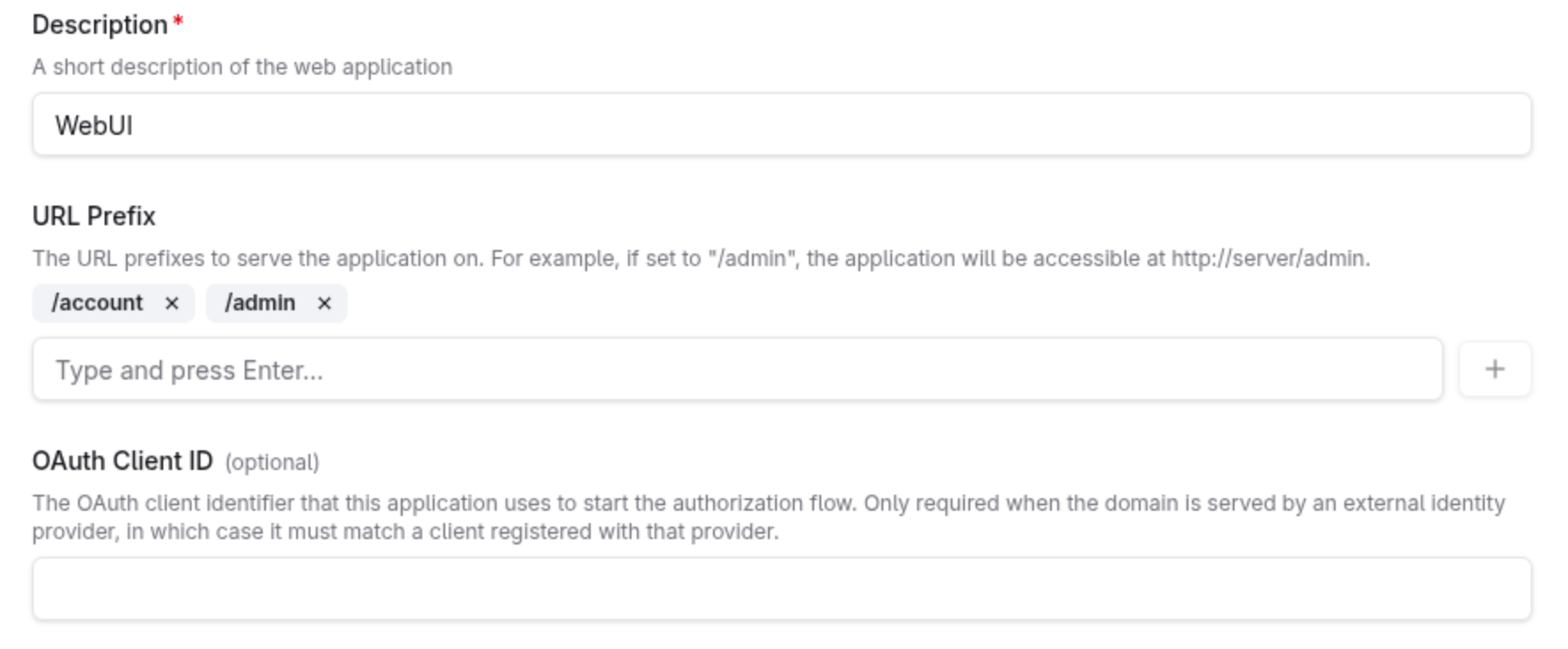

I think it’s possible since 0.16.19, in the Web Application settings

Only setting this to a custom client id, doesn’t change anything. There is still the old client_id stalwart_webui transmitted to the IDP.
After configuring the client_id, I reloaded the server settings and restarted the whole server.

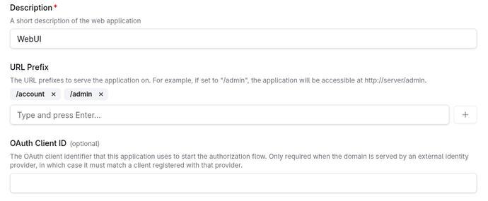

By setting the Stalwart Web Interface Resource URL to the version v1.0.9 (https://github.com/stalwartlabs/webui/releases/download/v1.0.9/webui.zip) it started to work.
Maybe it would have been enough to execute the management action “update applications” as the latest tag/url points already to the version v1.0.9
