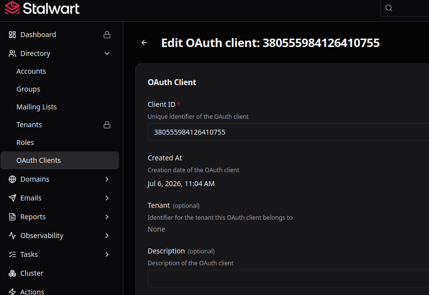

Problem with SSO Configurasion (Zitadel)

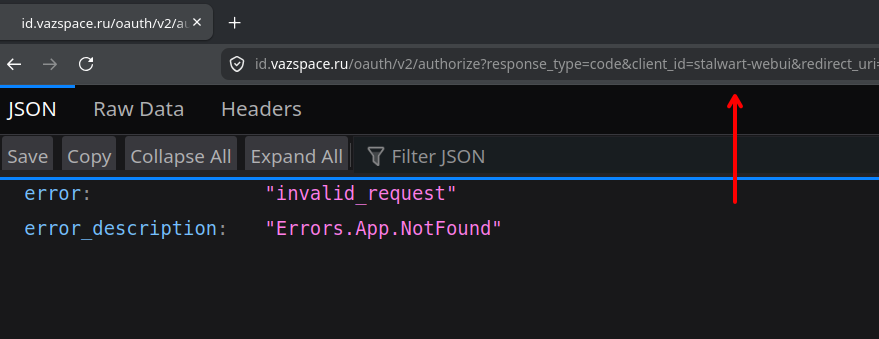

Stalwart redirecting me to my SSO Provider (Zitadel) and it shows me this error:
{"error":"invalid_request","error_description":"Errors.App.NotFound"}
Even when I correctly entered client id:
![zitadel-screenshot-2](https://i.imgur.com/NhASOTh.png)
![stalwart-screenshot](https://i.imgur.com/7x5orIx.png)
(An error occurred: Sorry, new users can only put one embedded media item in a post.)

That Errors.App.NotFound is coming from Zitadel, not Stalwart: it means Zitadel has no OAuth application matching the client_id in the authorize request. So the thing to check is that the client_id in Stalwart’s OIDC directory config matches the Zitadel application’s client_id exactly (no stray whitespace, right project, app not deleted).
Also confirm the Zitadel app is a Web/OIDC application with Stalwart’s callback URL registered as a redirect URI, and that issuerUrl points at your Zitadel instance so discovery resolves the right endpoints. If you can re-post the Stalwart directory config (you hit the one-embed limit last time) and the authorize redirect URL with secrets redacted, I can compare the client_id directly. Docs: OpenID Connect | Stalwart .

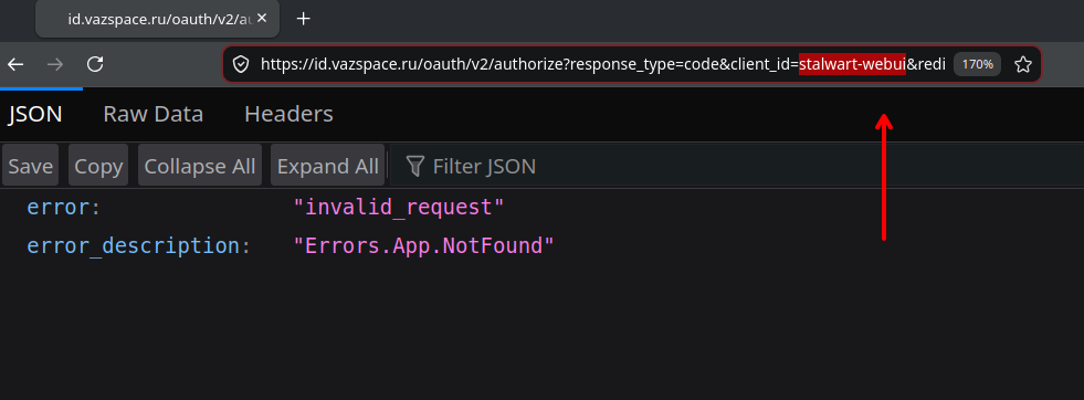

I entered client id correctly, but it still redirects me to Zitadel with client id “stalwart-webui”.

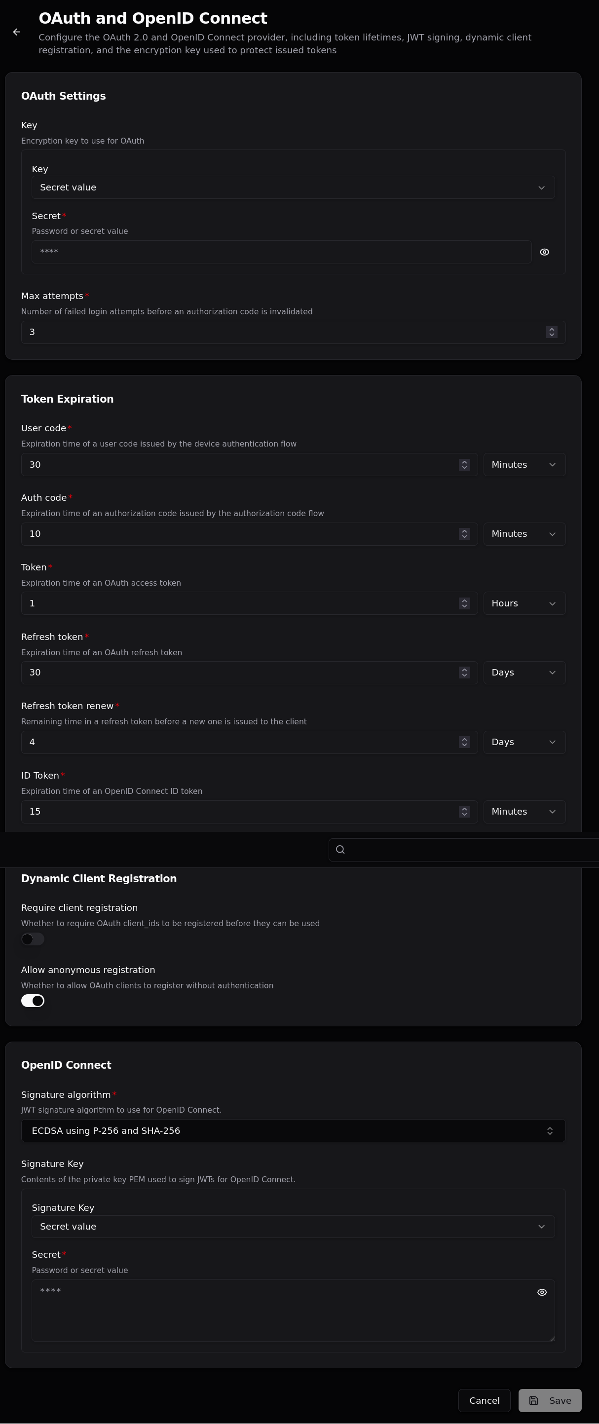

Stalwart has two sides of OIDC support - one is Stalwart being an OIDC provider and the other is Stalwart being an OIDC consumer / client - Overview | Stalwart. You’re looking at provider configuration, not consumer.
You need https://yourdomain/account/Settings/x:OidcProvider to configure as a client.
I don’t see client id field in this page:
Ah sorry, that’s the opposite link.
From https://yourdomain/account/Settings/x:Directory, add a directory ( Portal ), change to OpenID Connect, enter your issuer information.
We don’t have a client ID in our usage of it, since we’re proxying through another service that constructs the authorization request for us.
I’m not sure how you’d be able to get this to work otherwise, it’s a bit weird.

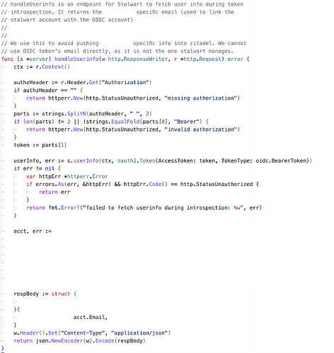

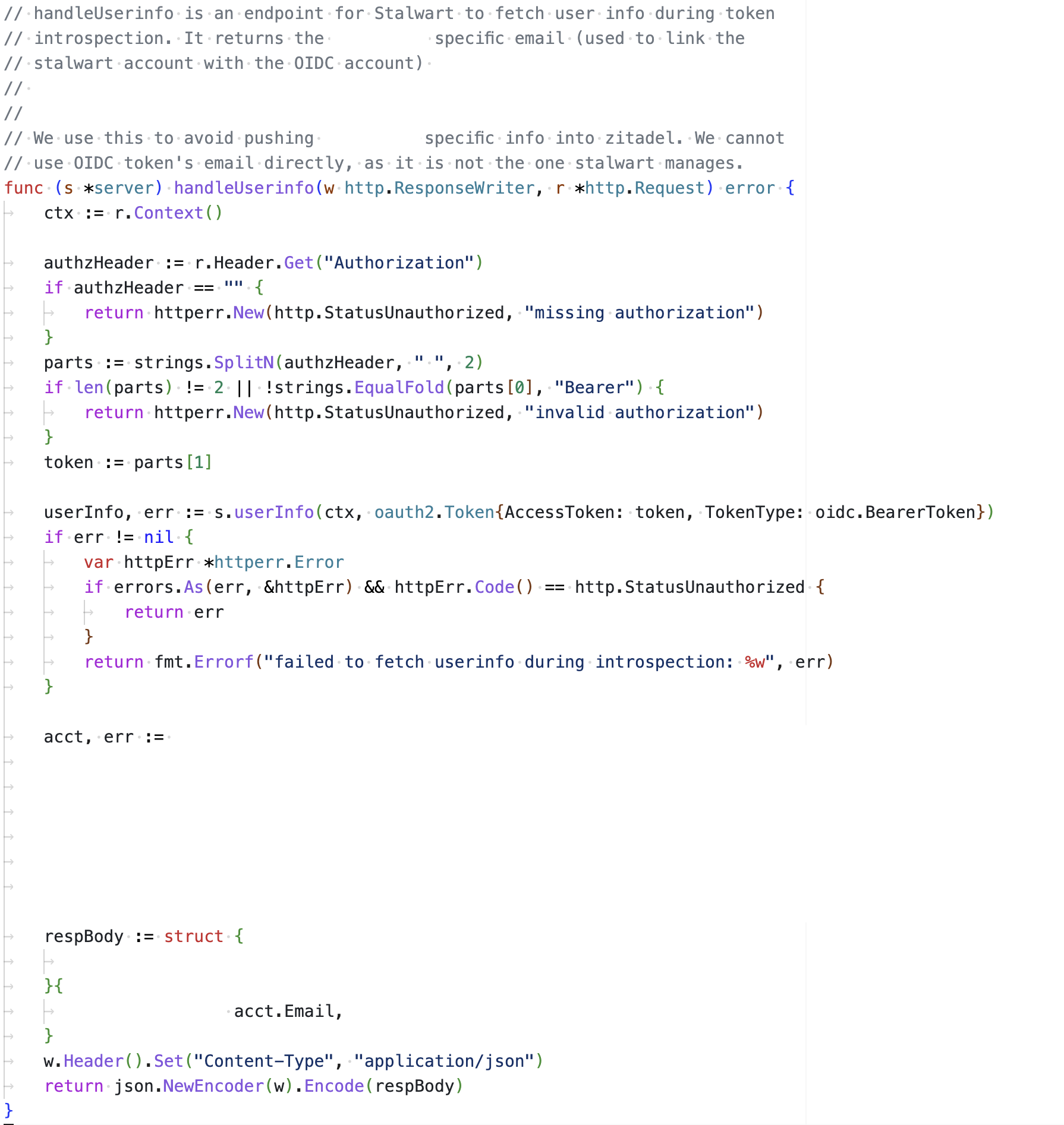

Yeah, weird. We’re using it against Zitadel, but like I mentioned, we’re using a custom proxy that rewrite the oauth authorization request.
could you share how you achieve this?
Can’t share much more than this - it’s literally just a proxy on the user info endpoint.
Then we have another couple endpoints straight proxying OIDC configuration and a JWKS.
