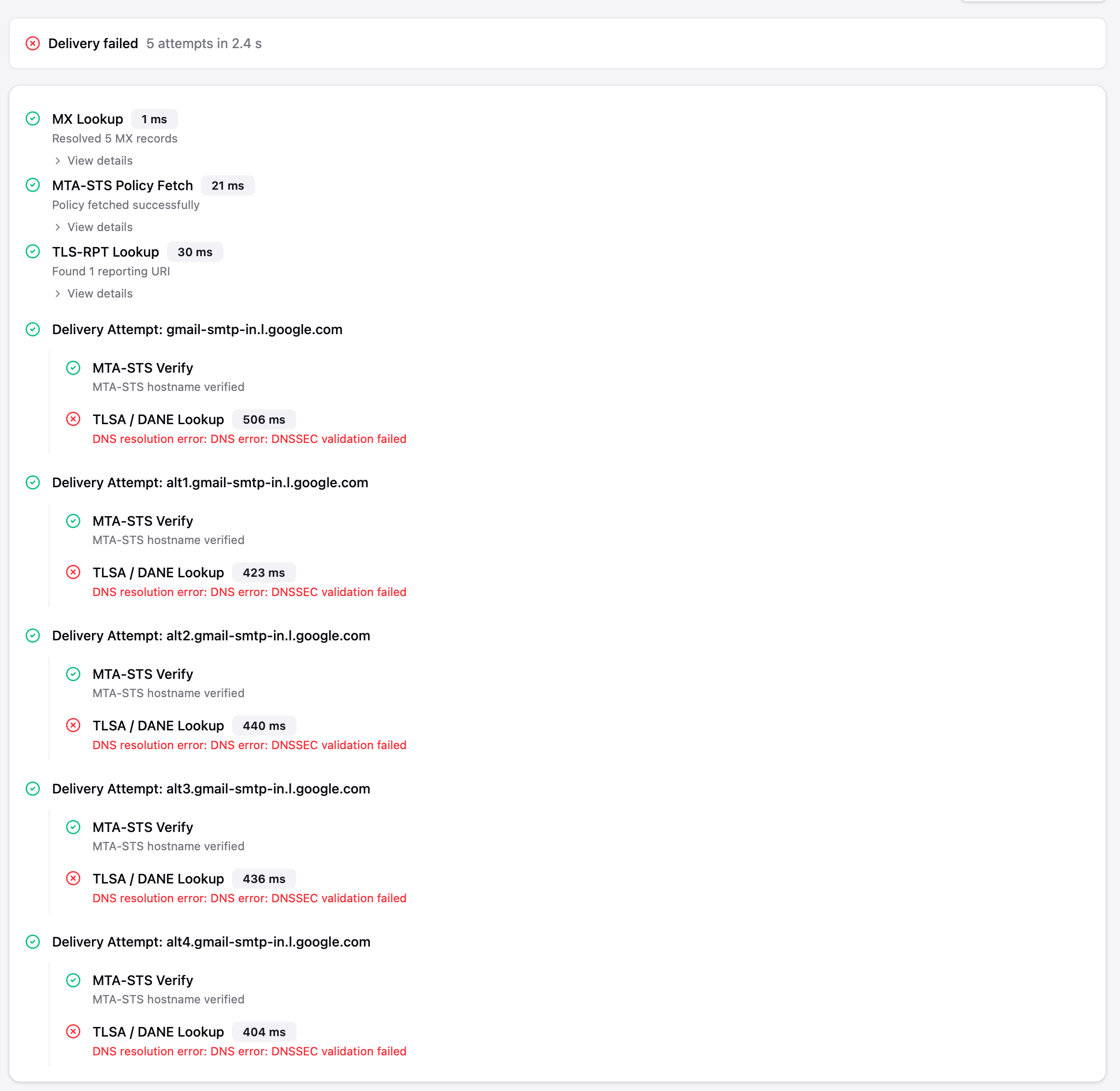

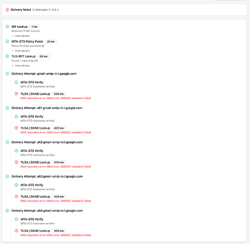

Happening to me too, since the 16.21 update.
Proton domains are also affected.
It’s due to a hickory-resolver bug, rollback to the previous version or wait a few days until 0.16.22.
Version 0.16.22 did not fix the issue. I am having the exact same issue with Proton domains at the very least.
Also continuing to see this error with 0.16.22; with proton domains and gmail.

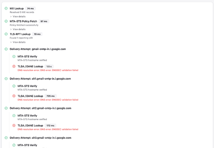

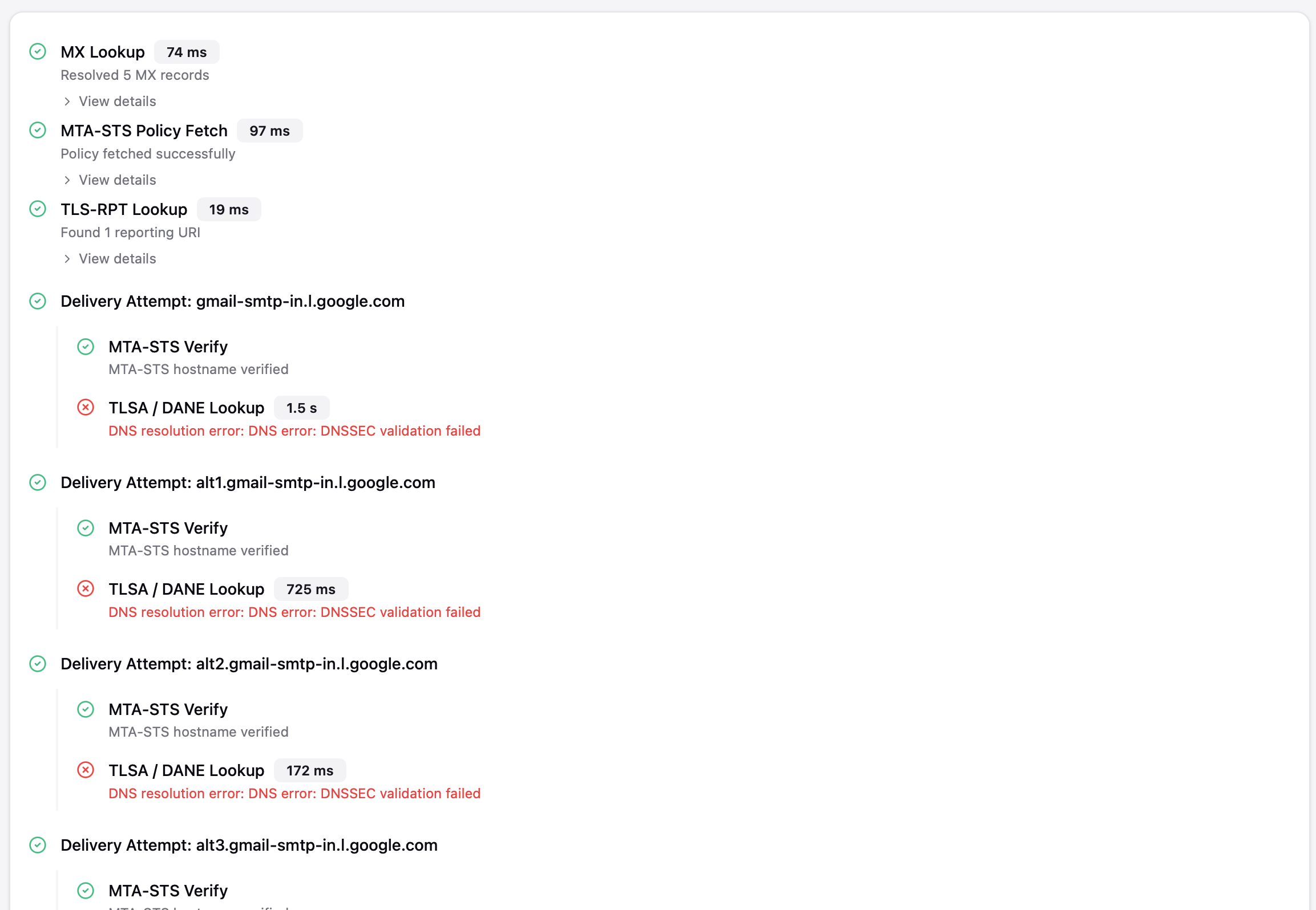

Strange, it still doesn’t work for me. Is there a reset I need to do somewhere.
Current version:
2026-09-22T03:05:22Z INFO Starting Stalwart Server (server.startup) hostname = “xxxxxxxx”, version = “0.16.23”

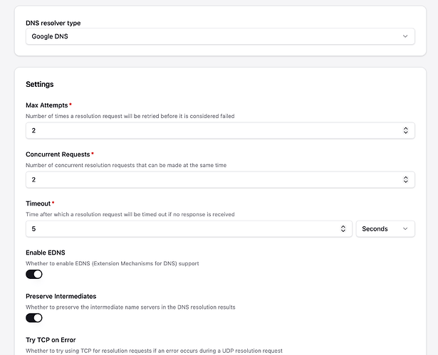

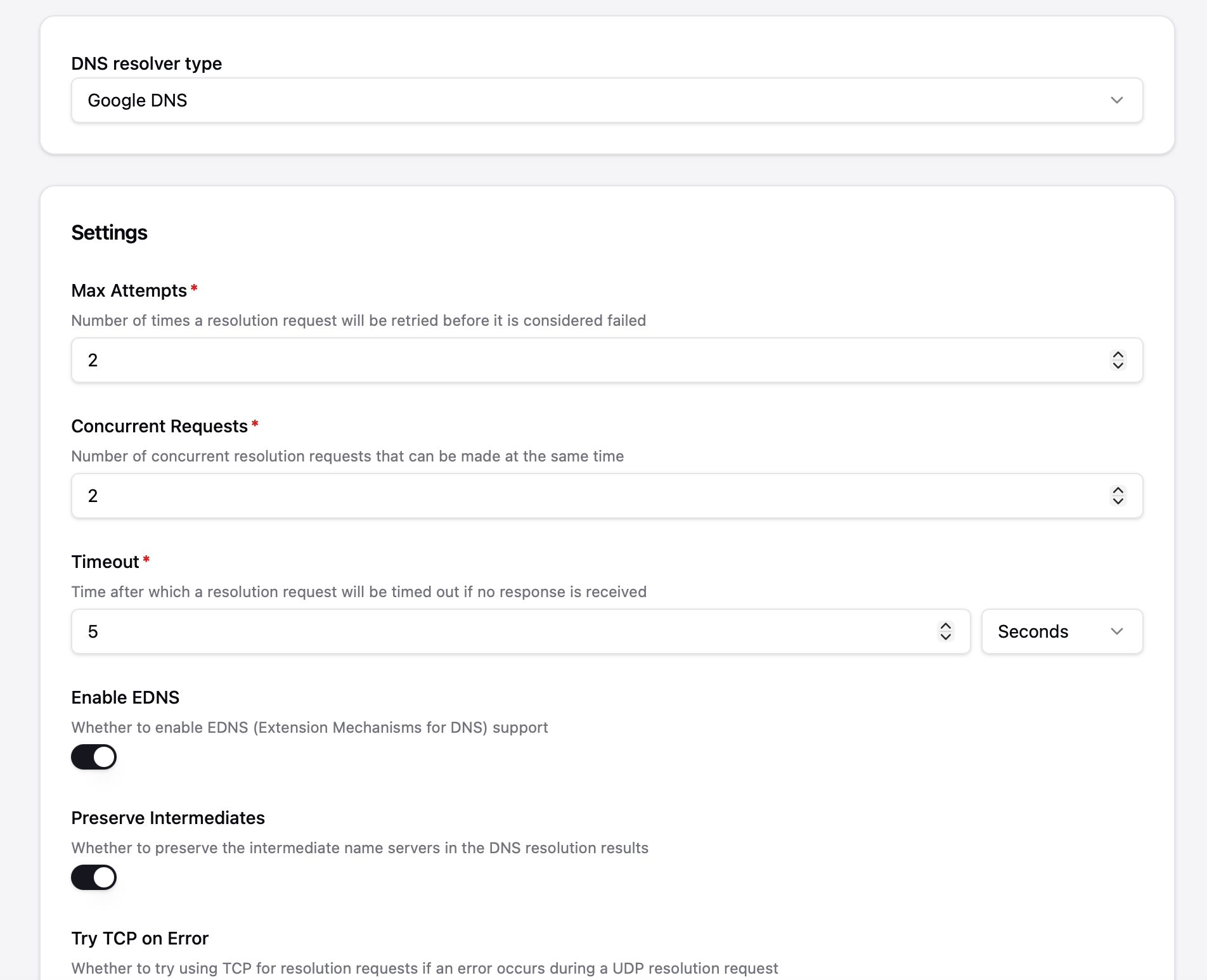

What DNS resolver are you using? It may be the source of the issue if it doesn’t return results correctly.
I was using System, which defaulted to my network hosts’ DNS. I changed it to Cloudflare, then Google, and got the same errors. Downgrading to v0.16.20 still resolves the issue.
