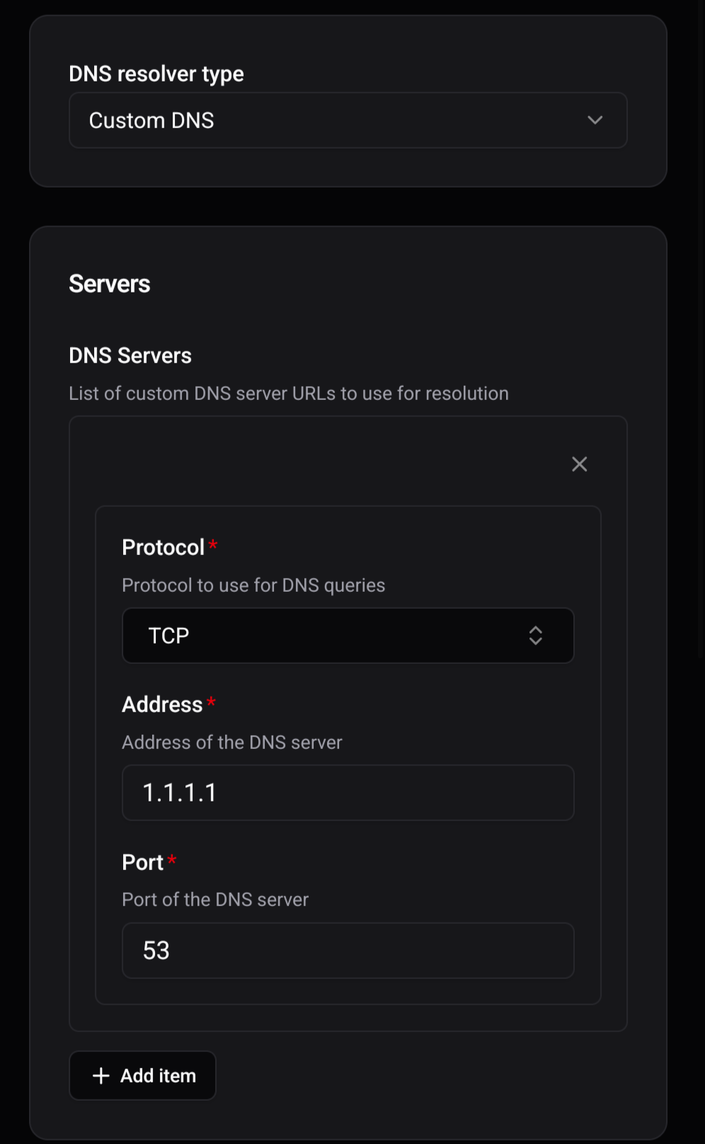

You have to enable TCP in your resolver or disable DANE.
I have already configured my resolver to use only tcp with the cloudflare DNS 1.1.1.1
I also rebooted the entire server after I saved the settings. The error still appears.
There’s not much we can do here unfortunately, Bogus is the validation result that hickory is reporting. Try using a different resolver such as a self hosted one. Most Bogus errors are due to large DNSSEC responses being truncated, but this should not be the case with TCP.

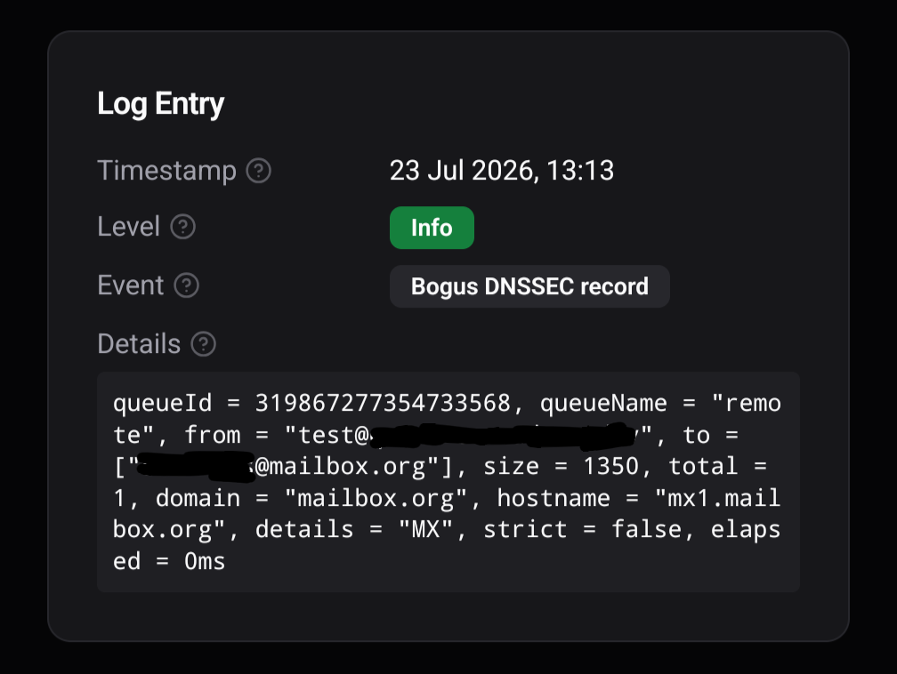

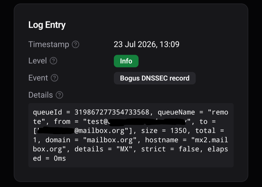

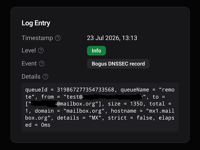

So, I just ran into the same issue with a recipient on mailbox.org, too. Upon further inspection, this appears to affect all users of mailbox.org, no matter if it’s their own domain, @mailbox.org, or @temp.mailbox.org. It just complains about bogus dns records - despite them not being bogus (although midly questionable given RSASHA1NSEC3SHA1).
After I dug a bit deeper, this indeed was a hickory bug: fix(proto): verify RSASHA1-NSEC3-SHA1 (alg 7) with the same crypto as RSASHA1 - Pull Request #3691 - hickory-dns/hickory-dns - GitHub - turns out they just claimed all alg 7 sigs were bogus. It is already fixed in the repo, but no release with the fix is available yet. Slightly annoying.

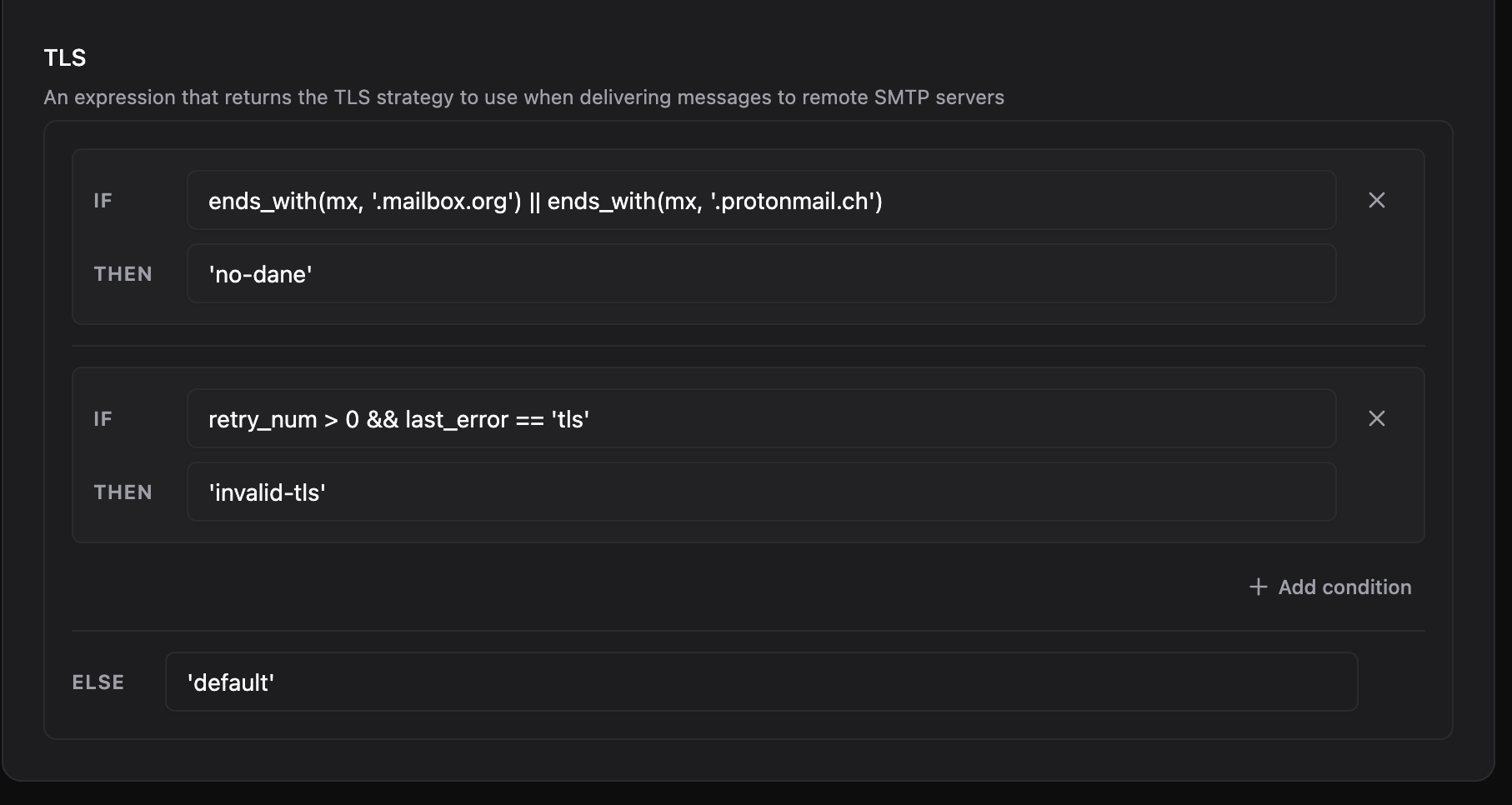

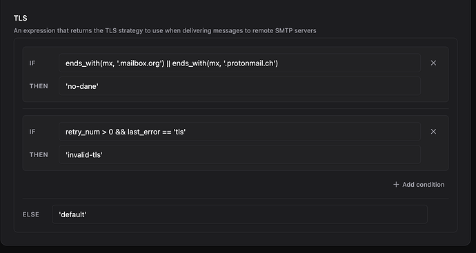

Because I did not want to turn off DANE globally, I created a no-dane strategy in Settings > MTA > Outbound > TLS Strategies where I turned DANE to “disabled”, and then used the Strategy > TLS setting to use that TLS strategy for the two known domains that affect me (ends_with(mx, '.mailbox.org') || ends_with(mx, '.protonmail.ch')):
To me, that’s better than disabling DANE globally, so… yay?
Edit: Ah, protonmail isn’t even affected. The issue with protonmail is truncation, but I was never affected by that since the hickory issue only effects mailbox.org - and the other domain OP mentioned since they also use RSASHA1NSEC3SHA1, funnily enough…
