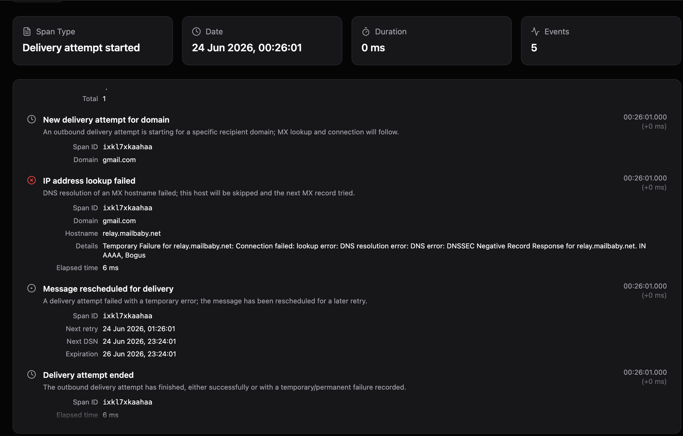

Stalwart's resolver is doing its own DNSSEC validation that no resolver choice disables, and it's wrongly flagging the (legitimate, unsigned) NODATA AAAA as bogus
Stalwart’s resolver is doing its own DNSSEC validation that no resolver choice disables, and it’s wrongly flagging the (legitimate, unsigned) NODATA AAAA as bogus
Check image for error
Also reported in Not able to send emails to certain domains due to DNSSEC error and noted that 0.16.9 does not have the issue while 0.16.10 does.
yes, you’re right, I’ve to use smtp relay ip address instead of hostname to bypass this error.
The real solution was found in this other thread:
The “bogus” responses are the result of UDP truncation. When using a custom UDP resolver, add a fallback TCP resolver that can handle responses too large for UDP. If your resolver supports TCP, then just add a second entry pointing to the same IP and port but using TCP instead of UDP. Using DNS over TLS would also avoid this problem.
