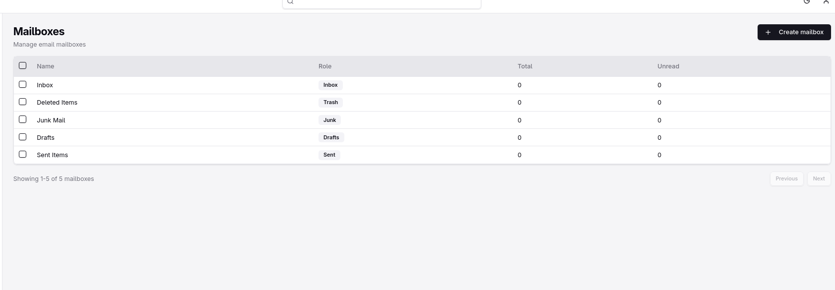

I was unable to get the account id from the above location, but this is a screenshot from the account page for the account in question:
The instance I have running on :8082 was the new one, while the old one was running on :8081 and even though I specified the URL to be at :8082, it seemed it did indeed use the old instance.
Probably the JMAP session resource on the new server is pointing Vandelay to your old instance and that’s why they are being skipped?
