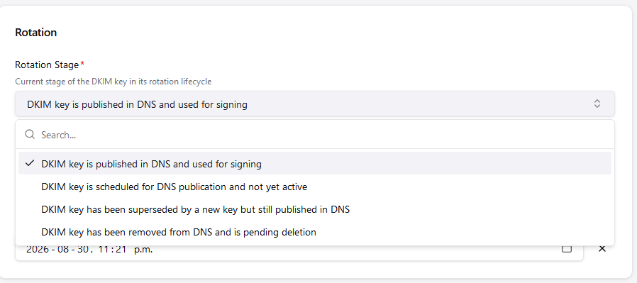

If you’re not using Automatic DNS management, I believe you have to change the signature from Pending to Active yourself.

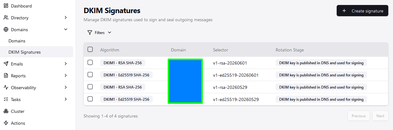

Possible something went sideways in your create/remove, you could always make a new one here and mark it Active.

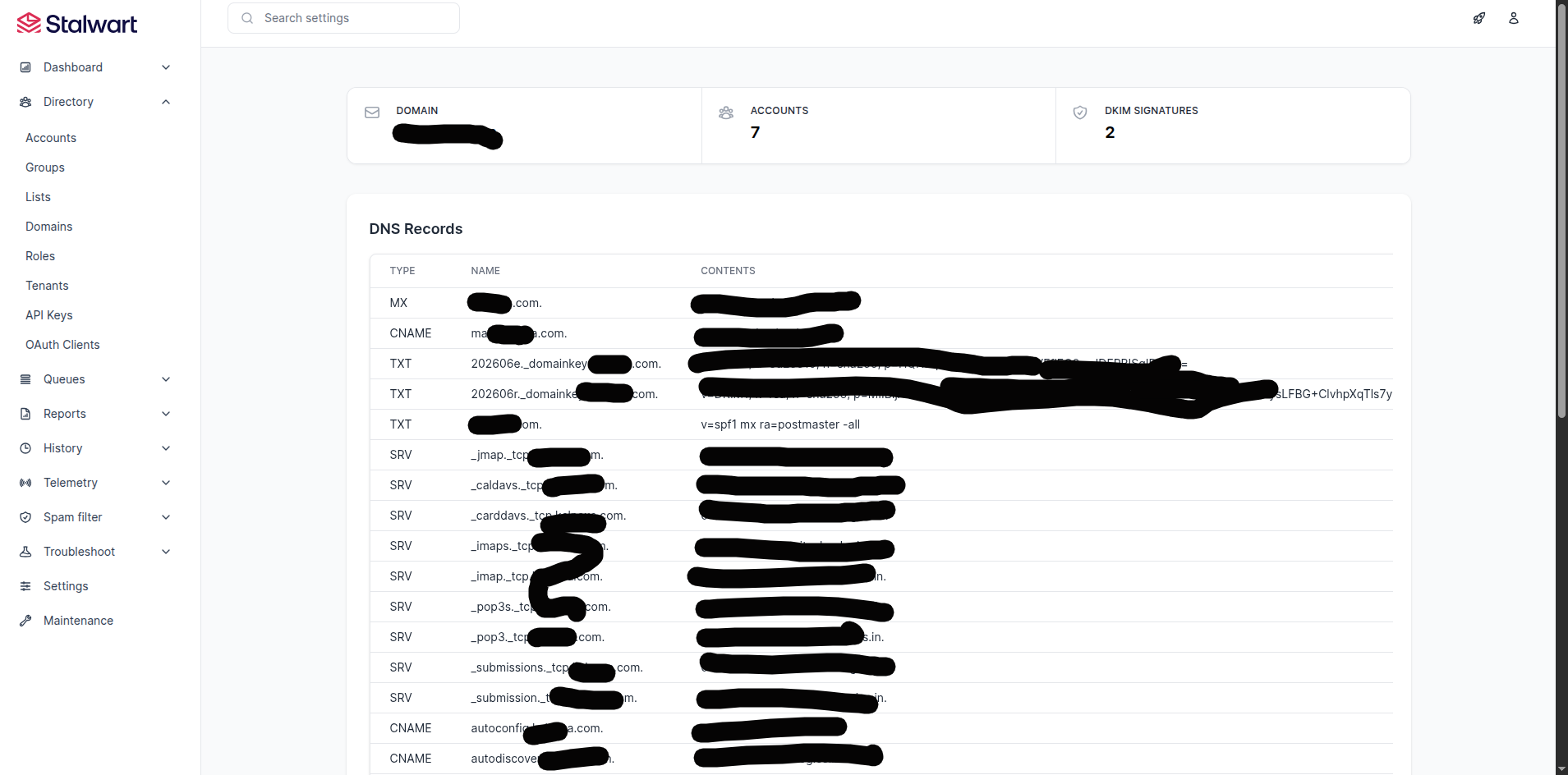

this is how my UI looks like
I just noticed you’re running an old release, 13. The Web UI changed greatly from 15 to 16. You probably still need to mark the signature from Pending to Active, but I would have no idea where it is in that UI. Is the “2” in the DKIM count clickable?

Check out this announcement from yesterday.
