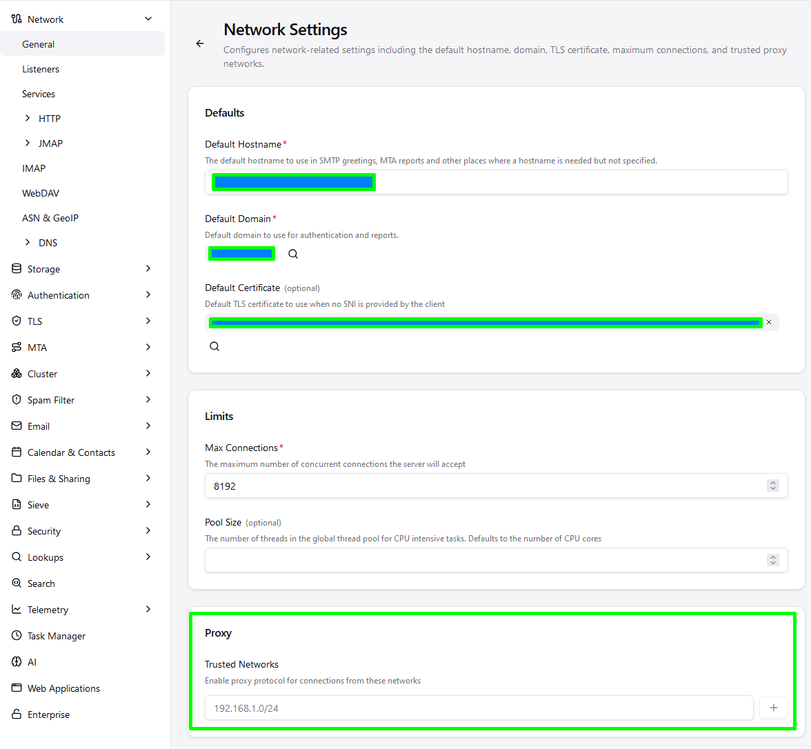

The page is titled “Network Settings” but the menu item is actually Network → General. It’s the very first page in Settings, at the bottom of the pane.
if I add the address there, I’m getting this issue and I can’t access the admin UI anymore :frowning:
