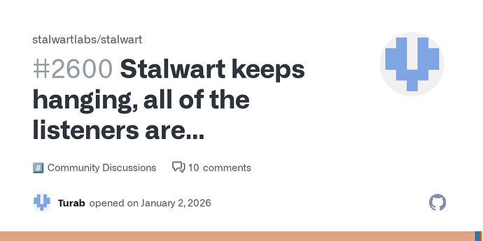

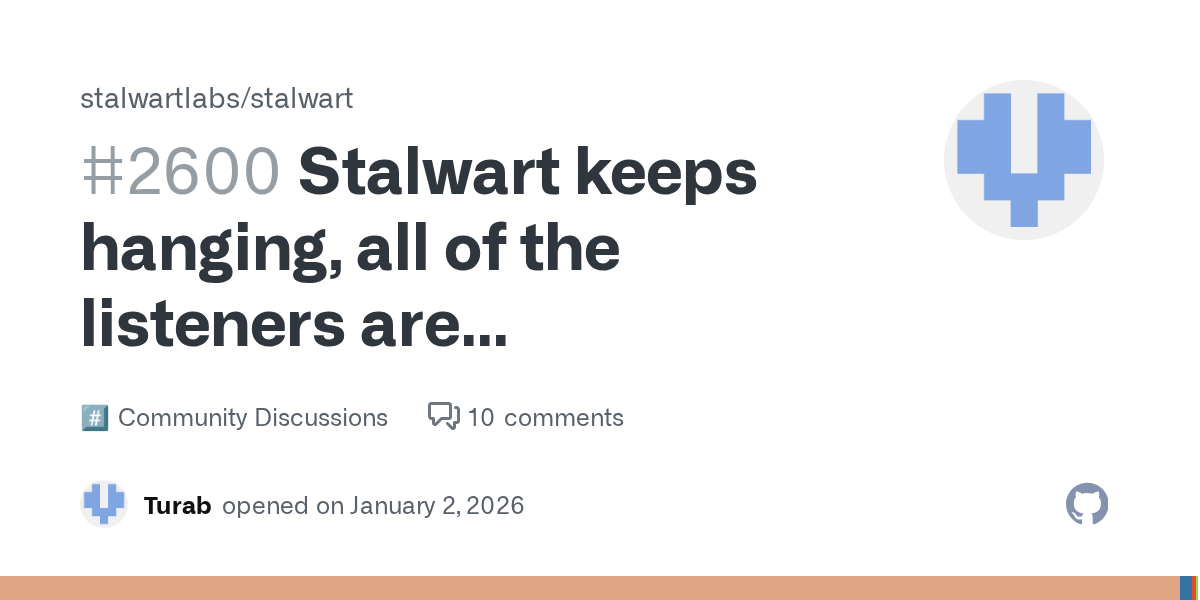

But one thing I forgot is that I had put a watchdog to restart Stalwart in case it hangs, due to this discussion:
So during the upgrade, after I stopped the service, the watchdog I placed kicked in and started Stalwart back in about 2-3 minutes, without me noticing it. Then when I tried to start the new binary in recovery mode, it complained that something was already listening on port 8080. Then I realized it and killed back the respawned process and finished the upgrade process with no further errors.
