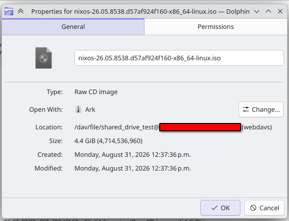

Eyy Look at that! That number of bytes is larger than u32::MAX
I’ve kept the thing squashed to a single commit to make rebasing easier. Here it is!
I plan to keep up with upstream every time a new release is created.
I wasn’t able to create a new config option as that requires changing the schema which I don’t have access to, so the tempfile dir is set with an env var, and it’s currently hard-coded to spill over after 1MiB.

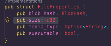

There’s a lot going on in this thread. You basically need u64 instead of u32 for file storage file sizes?
Ha, apologies (and thank you for visiting my thread of ramblings), to really condense over a week’s worth of effort:
  • u64’s for file storage sizes and quotas
  • don’t buffer whole blobs in RAM when possible, either just use AsyncRead/AsyncWrite streams or create a temporary file if needed.
    • I’m actively storing files that are larger than total system RAM right now.
The giant list I’ve made a couple posts ago just went into the specifics of what had to be done to achieve this. (Though my approach to Server::blob_get is different now than it was before) I’m personally using the fs blob store uncompressed, but I made sure to make it work with all other blob stores with compression enabled.
