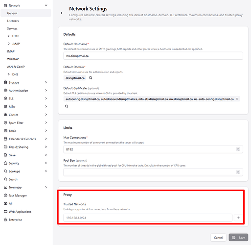

  3. Go to system settings and configure trusted proxies, then restart again. → Proxy Protocol | Stalwart

After the onboarding has finished and Stalwart has been restarted I set step 3. Currently setting it open very wide to the two smallest private CIDR ranges because that’s the two used in my network, once everything is working I will pin it to the exact IP.

You have Proxy Protocol enabled, do you have the IP address of the proxy listed in TrustedNetworks? If not, it will not accept the connection as it is not expecting the header.

Two things seem to be the issue here. First, the backend sends PROXY protocol (send-proxy-v2), and Stalwart drops any PROXY-protocol connection whose source isn’t in proxyTrustedNetworks before it does anything with it. If the haproxy host’s IP isn’t trusted, the connection is refused before the TLS/ACME challenge is ever processed, which is exactly why you get the self-signed fallback and nothing in the logs. Add the haproxy IP (and 127.0.0.0/8 and ::1) to proxyTrustedNetworks. Disrupt’s reply is pointing at the same thing. For details check the docs at Proxy Protocol | Stalwart.
