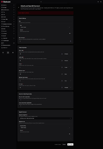

i checked it again, but i can not remove any provider entry or clear the fields and submit it.
Sorry, my bad, the instructions were to remove an external OIDC provider but you are using the internal one. The WebUI won’t let you save the internal OIDC settings unless you provide valid encryption keys, which can be generated using openssl.
Regarding the ECSDA error, Stalwart only accepted PKCS8 keys but v0.16.12 will also allow SEC1 private keys. In the meantime, make sure you save the key as PKCS8, convert it with openssl pkcs8 -topk8 -nocrypt -in key.pem -out key.pk8.pem and use that, or switch the algorithm to match the key you actually have.

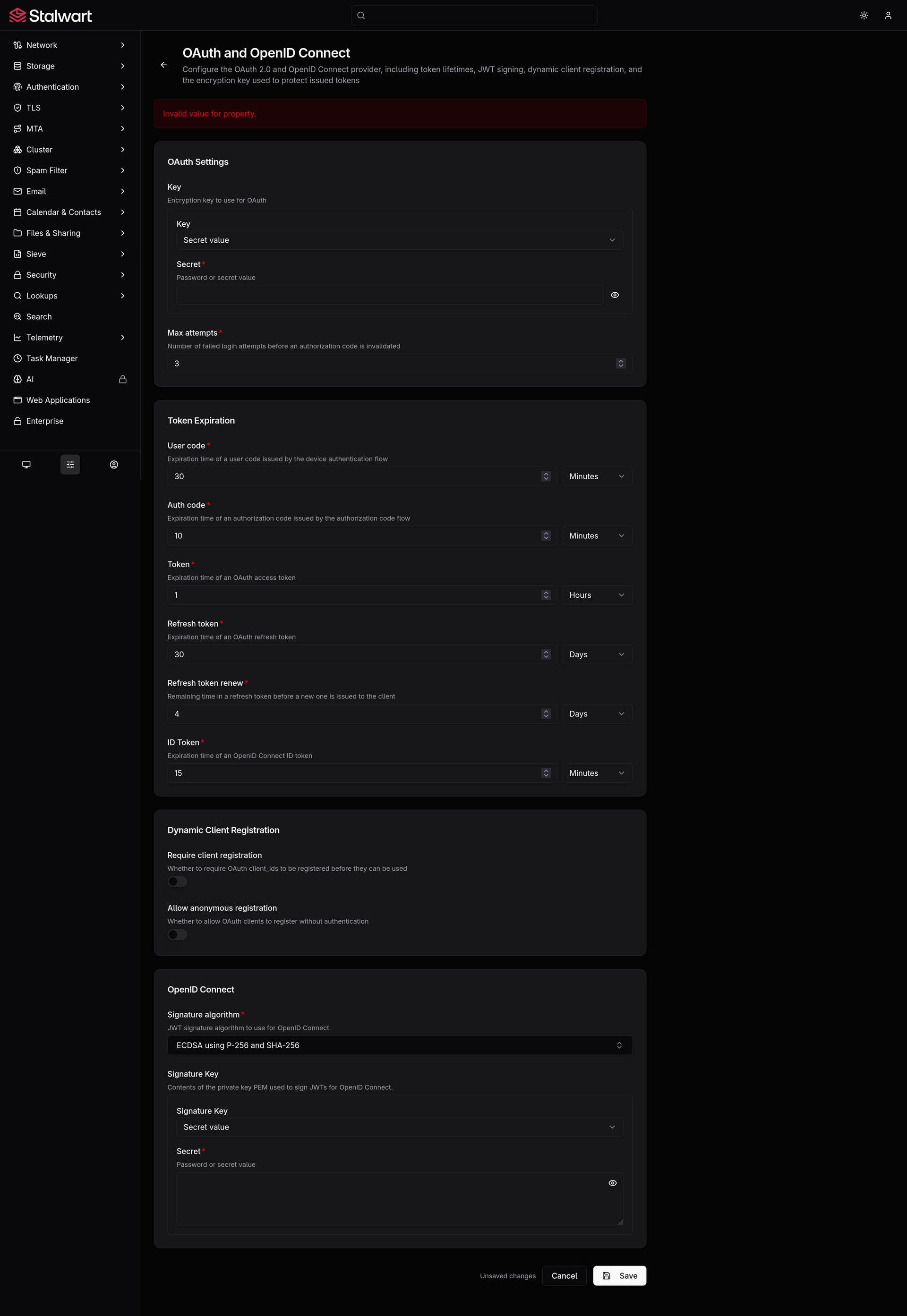

I’ve run into this issue myself. I believe OidcProvider is only partially configured. I misunderstood how to set up OIDC and meant to mess with OpenID Connect under the Directories settings tab. Because I was messing with OIDC Provider instead, I believe it became partially configured and is in an invalid state. Currently I must restart my podman container to apply new settings since the Reload Server Settings Action fails with “Action failed No usable ECDSA private key found in PEM”.
When starting the container, the following shows up in logs: ERROR Configuration build error (registry.build-error) source = "OidcProvider", id = <redacted just in case>, reason = "No usable ECDSA private key found in PEM".
When logging in via Bulwark, logs show INFO Authentication successful immediately followed by ERROR Authentication error (auth.error) reason = "InvalidAlgorithm", details = "Failed to encode ID token".
How would one reset OidcProvider to its default unconfigured state? All settings and data are stored via PostgreSQL 18.
This does seem to be the issue since running openssl ecparam -name prime256v1 -genkey to generate a key and entering it into the OpenID Connect Signature Key field set to ECDSA using P-256 and SHA-256 resolves the issue. I don’t plan to use this feature and would still like to unset the OidcProvider configuration to it’s default state.
What you have now is already the factory state. OidcProvider is seeded once at first start with a generated P-256 key and es256, and being a singleton it cannot be deleted, so a fresh P-256 key with signatureAlgorithm set to es256 is exactly what a new install looks like. If you would rather park it, hs256 with any random string as signatureKey also works, since the HMAC path takes the raw secret.
